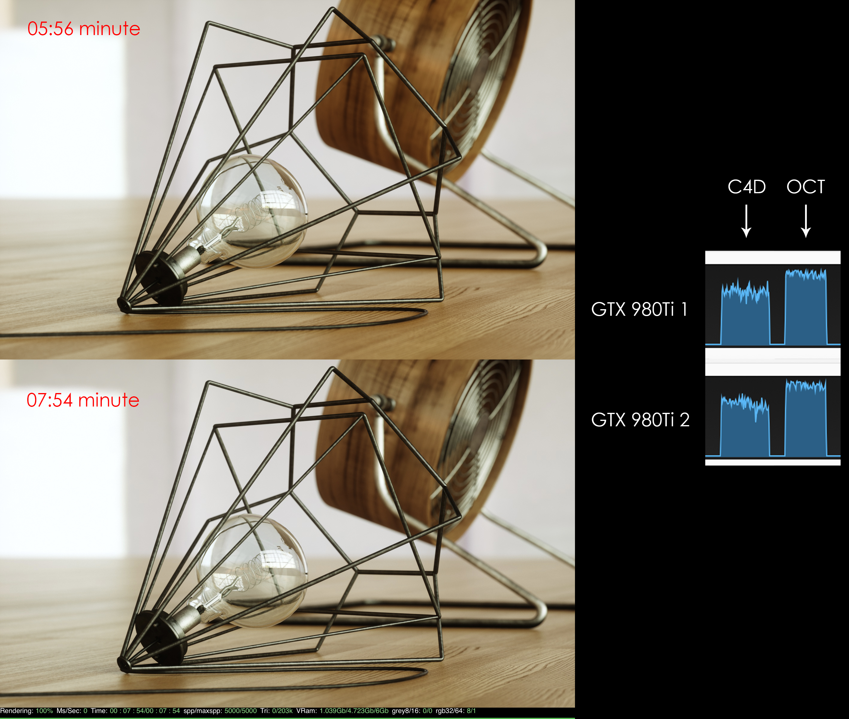

iMac - 4GHz i7 - 24 GB RAM- OSX 10.12 - 2x GTI 980 Ti - 2x eGPU Thunderbolt Bizon BOX - C4D R17
Here you can see the speed difference with the same scene.

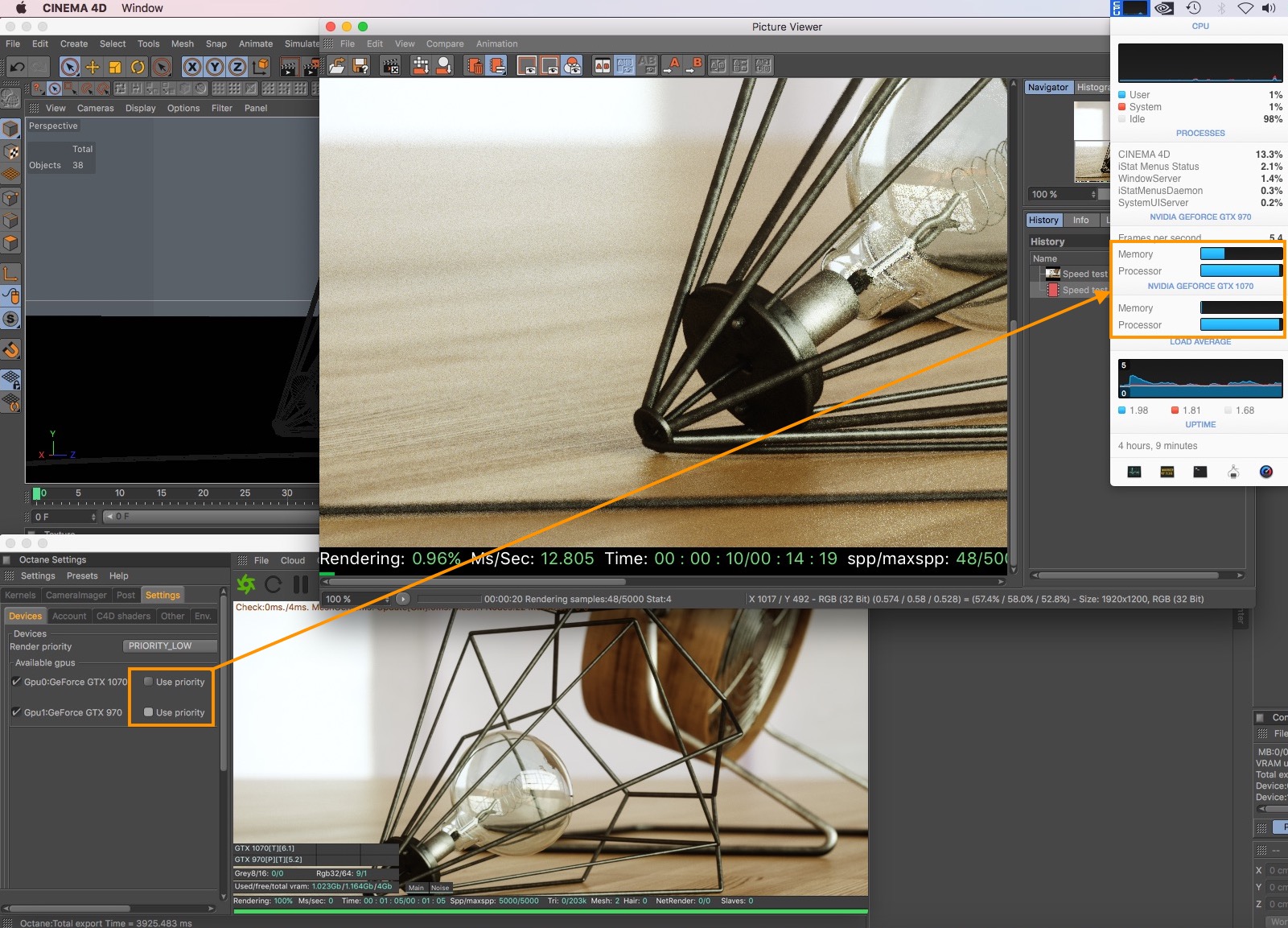

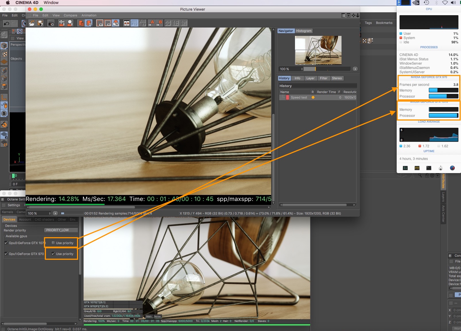

I'm quite sure that the issue depends on your setting in the Devices tab, and in particular, the Priority option:
with Priority Low
with Priority Low
no Priority
no Priority
Probably in Standalone the Priority option is disabled or set to High, so the GPUs are used almost at full power.
ciao beppe

Thank you very much Beppe!! The issue was the priority setting :)

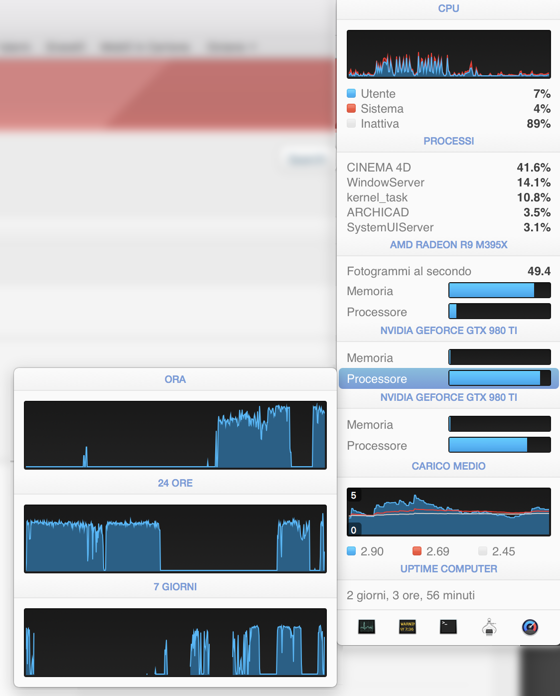

For the GPU graph under Os X I use iStatmenu, if you select the processor of the GPU, you can see the graph.

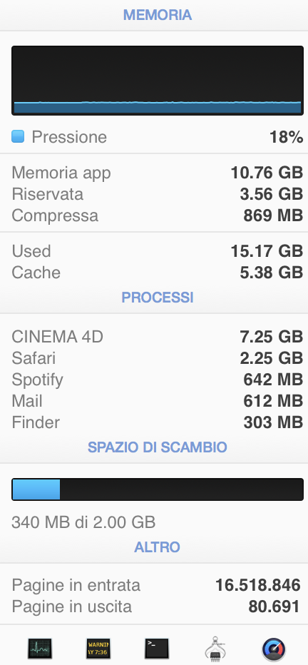

what about system RAM?

Unfortunately I cannot share this scene because it's a scene of an work in development.
However seems to be no problems with the RAM
