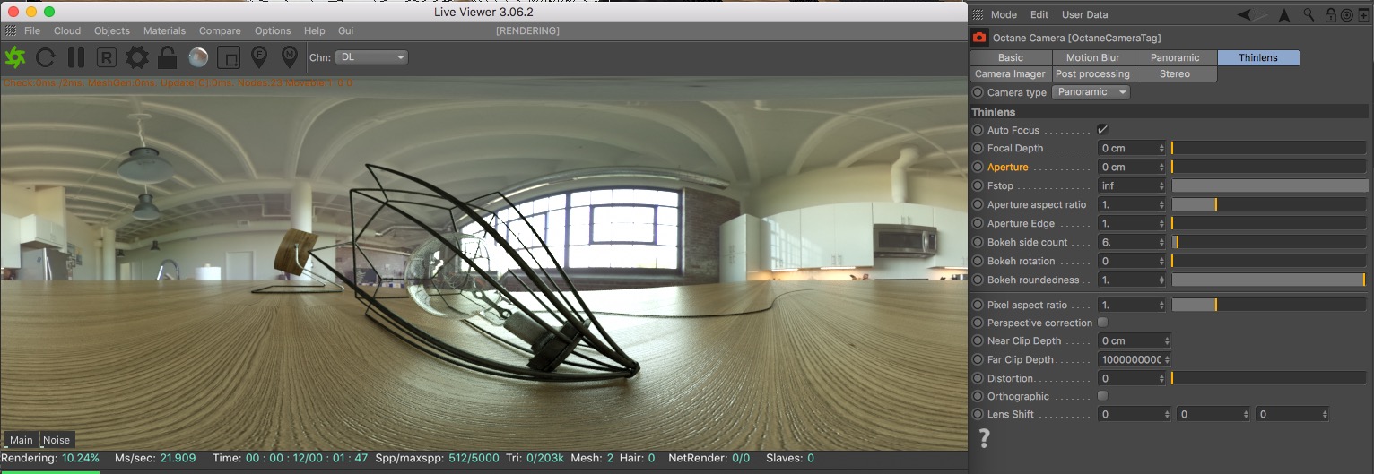

Ciao Enzo,
pay attention that in one of the latest update, the complete DOF control has been added to Panoramic camera. So set in the Octane camera tag the Aperture value to 0 to completely remove the DOF effect:
