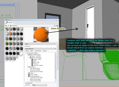

Hello Paul,
One thing that would help me alot would be to be able to tell octane which texture or color should be handed over to the rhino viewport display. As far as I understand it (please correct me if I am wrong here ...)
there is one hidden Rhino material resembling each octane material. E.g. when we have a simple diffuse octane material with a bitmap texture in the diffuse node , this texture shown in the rhino viewport (when the display is tuned to shaded and "use rendering material")
Once this texture is placed e.g. in a multiple material it is no longer visible in the viewport :-(
My suggestion would be to have a function to select the node and then do a rightclick on it and select an option like "show this color / texture in viewport".
Such a feature would also be very handy for a lot of situations where you only want to have a certain texture temporarily visible e.g. to align it.
I hope it's not to complicated ...
best
Andreas

Hi Andreas
The tree structure used for Octane materials is stored as Octane nodes - so adding additional info (like "Use this texture as the diffuse texture in the Rhino preview") would be a very difficult thing to implement - sorry.
well that is very bad news then, because it is a very important and basic functionality IMHO, my current workaround is to temporary place the texture I want to examine or modify in the diffuse slot and exchange it when i am done but this is very cumbersome...
