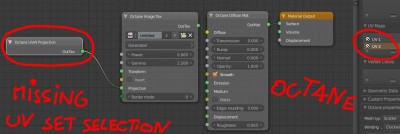

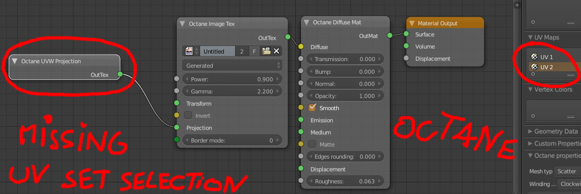

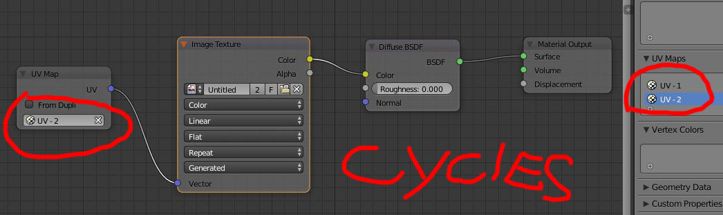

Hi Azen,
Thank you for looking into it.
There should be no limitations from Blender side of things. To me it seems that multi UV support is just not added to Octane plugin, cause whoever programmed it didn't get to that part YET or whatever the reason was. The Octane UV node is there and is called "Octane UV projection". It just doesn't have the UV's listed to select from. So its kind of halfly done already.
I'll add 2 screenshots for you to explain better. (one from Cycles and one from Octane)
For my studio this is the highest priority thing and we can't use Octane for Blender because of it.
Suv

suvakas wrote: Hi Azen,
Suv
Thank you for that breakdown. Initial indications seem to suggest that this feature should be feasible for Blender, as you say.
Cheers,
Azen
