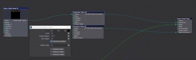

Hi Everyone,

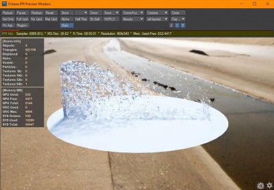

Just checking but is anyone else running into an issue with Octanes Visible environment not working in Lightwave in the latest versions? I only noticed this while running some tests on a mesh sequence for a water effect.
Does anyone know whats going on? By all accounts I should be seeing a red background with red reflections.
Cheers!
Draydin_r

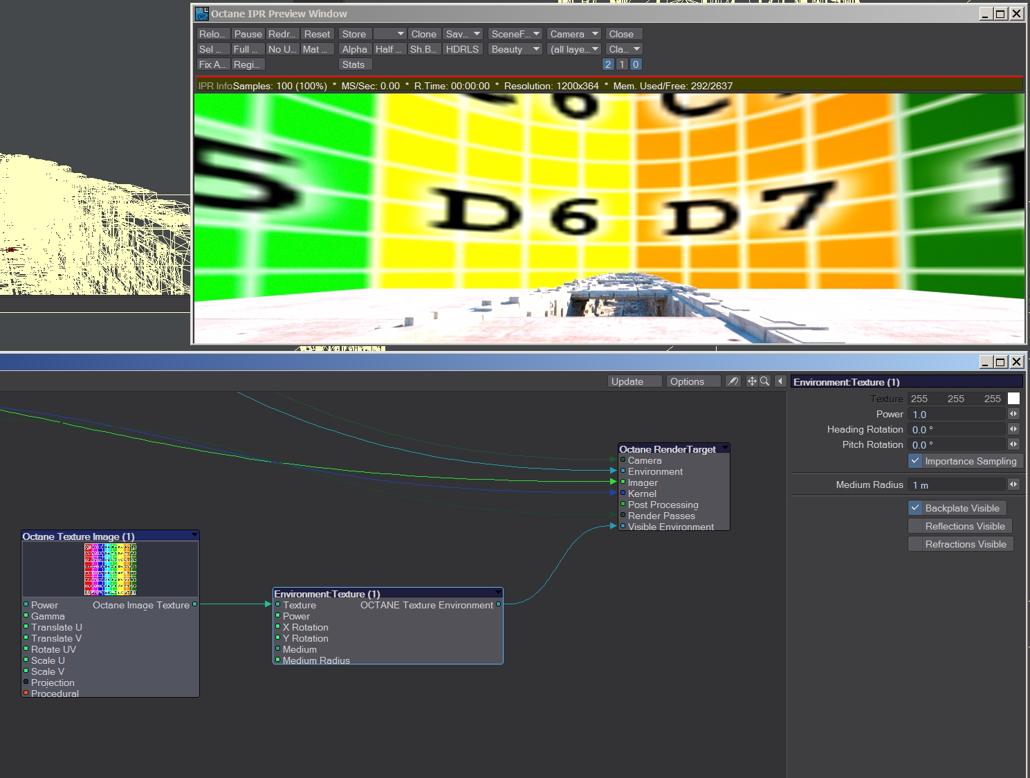

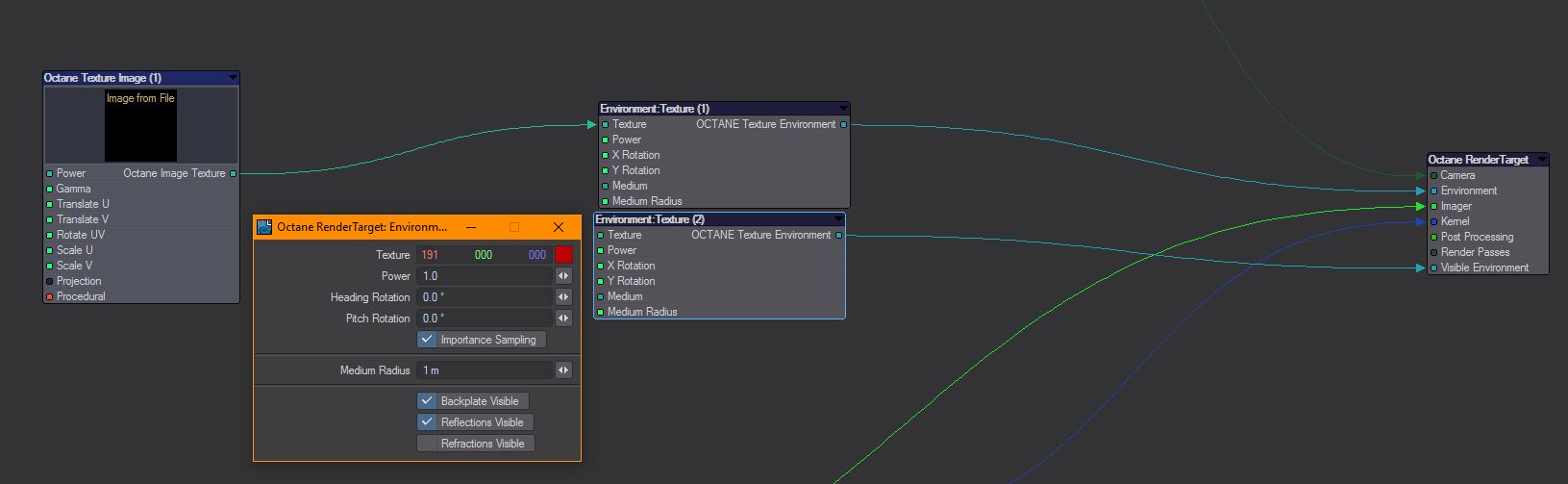

Sorry Juan but doesn't work for me ! Attach Texture image to Texture/Environnement Texture and nothing ! Whati'm doing wrong ?
juanjgon
Posts: 8867
Location: Spain
Here now this feature works fine. Something can be wrong in your scene setup, for example the alpha channel settings on the kernel node. If you want to attach a sample scene, I could test it here.

Yes, it's me ! All is ok !
