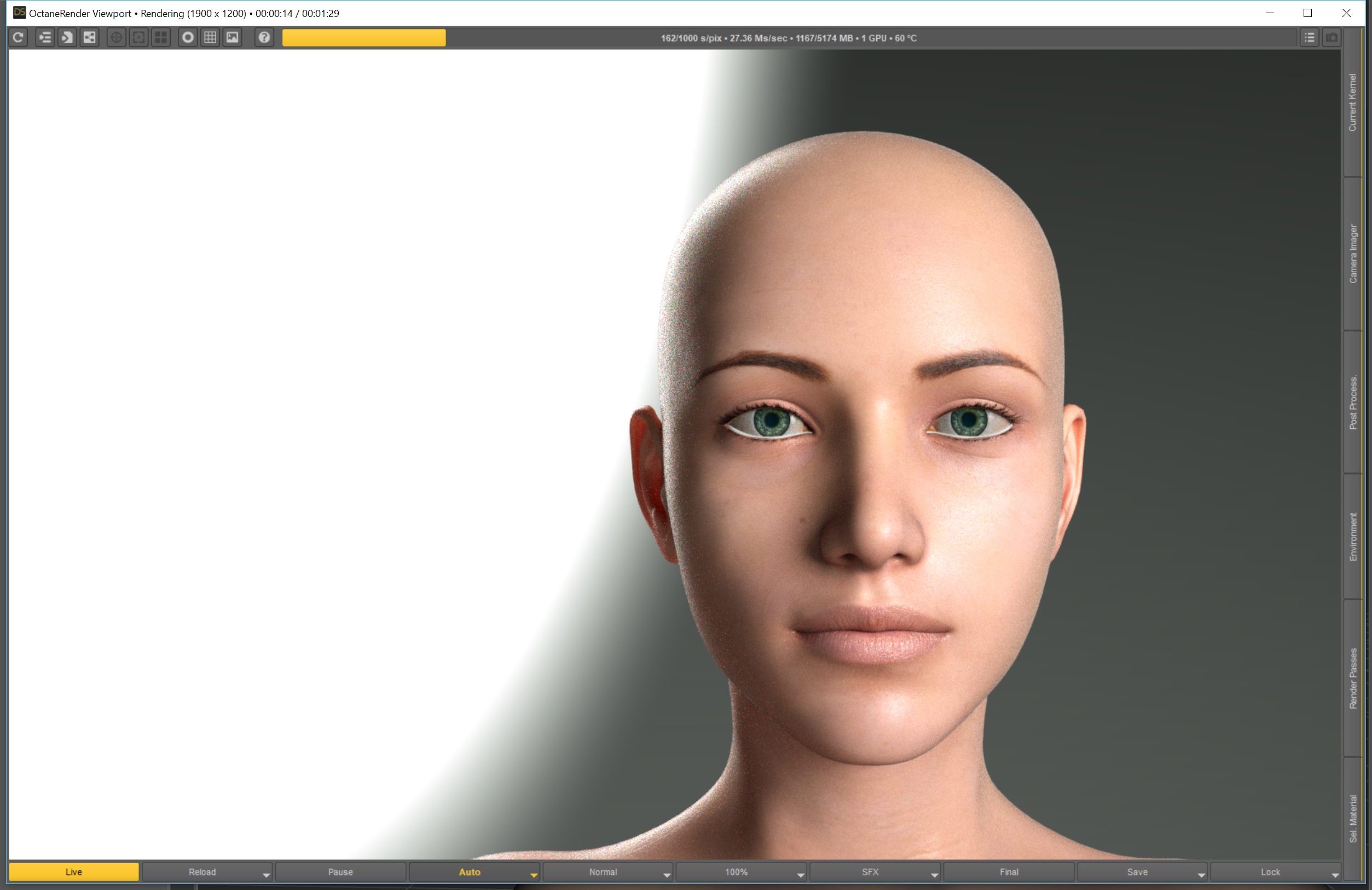

I am wondering how to fix this issue with Genesis 8 and the new eyelashing system.
As you can see there is a white basis which looks like an eyeliner at first...but it is the basis of the eyelashes.
Any ideas how to get this fixed ?

The problem is, that with the new EyeMoisture coming with the Eyelashes figure, you now have two materials called "EyeMoisture" in the scene. This apparently causes a hiccup during the material conversion.
Grab this update for the OCDs plug-in here, that should fix it: https://render.otoy.com/customerdownloa ... _Win64.exe

But I am running a later version :
3.6.5.33
If I disable the "Try to map to GeoGraft..." in preferences...it does fix the issue but I don't know if it has other side effects if it's not enabled...

If I see this correctly, there seems to be a version numbering issue.
The link I posted above was posted after the version you're running on, at least if I can recall correctly.
I'm running the above mentioned one and I can leave the Geo Graft option in the Preferences enabled and still not have the issue with the eyelashes.
3.6.5.33
Pls use the latest release which I just posted at viewtopic.php?f=44&t=55214.
