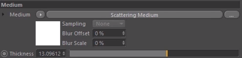

In the C4D version of the plugin there is a thickness slider control under a medium node such as a scattering medium (when using an HDRI in an Octane Daylight setup) but in the 3DS Max version, there is no such control. Can this be added or is there a different control for that somewhere to achieve the same effect? And while we're at it, can HDRi environment use be more intuitive in 3DS Max in a future update to the plugin?
Thanks!
Add a thickness slider to medium controls

Hi Straticus77,
In Octane 3dsMax plugin, thickness slider is "medium radius", it works in meters.
