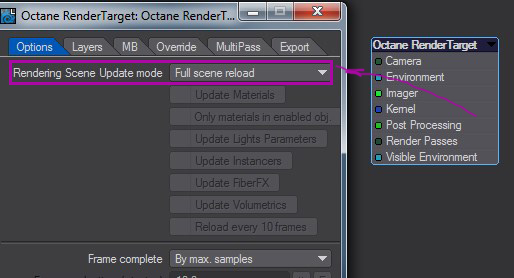

So I've got animation with bones but Octane isn't rendering the movement? Is there a flag somewhere to check why bones aren't working?

Try this

Set the render mode to "full scene reload" is going to work for sure, but the mesh deformations from the bones should be rendered also in "update scene" mode. If you want to send me a sample scene without your setup, I could check it here.
