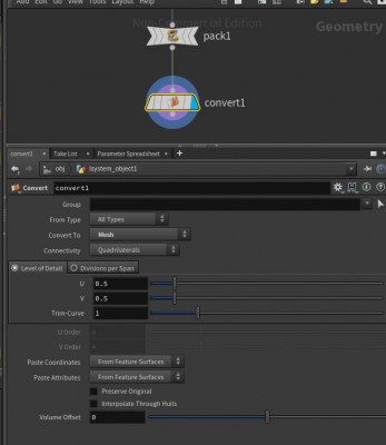

I didn't find the Convert SOP but only a "Convert". Are there any specifics in that menu that I have to watch for?

The Convert SOP is the node that you can add at SOP level to convert the Houdini primitives formats, as you can see in the attached image.

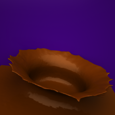

Thanks Juanjo! I think I got it to work (with help, of course!!!)
See image. I'll send you the file to see if there are better ways of handling.

Yes, the scene is right to me, at least from the Octane point of view. As you can see the key to render it with Octane is to add the convert SOP to convert the polygon soups to regular polygon meshes.
