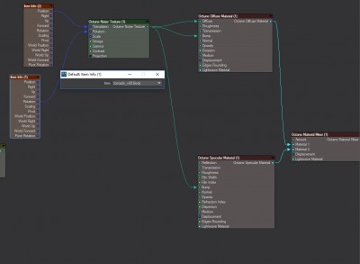

So I have a cylinder with an Octane noise procedural which is rotating on H, (lmagine a tornado) Now the cylinder is animated with bones and deformations. The noise texture is not tracking to the movement of the geo. Like it's using world coordinates. I've tried using item info (of the .lwo) to lock the position and rotation but it doesn't appear to "lock" the swirling noise to the displaced geo. Am I missing a simple step?

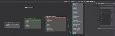

To lock a procedural texture to a mesh that has deformations you need to add a "Mesh UV" projection node, linked to the projection input in the texture node. The object needs an UV map, that will be used as a reference for the procedural to lock the texture to the mesh.

Thank you very much, I was able to cobble together that along with animating the UV map to get the noise to turn around the cylinder object. The second issue (Which is a general texturing issue) is that the cylindrical map does stretch at the top and bottom which is to be expected. I would like to figure out a way to use a gradient or something as an alpha channel on that noise node to remove the stretched area. This doesn't seem possible as I don't see any inputs on any nodes to allow for this?
