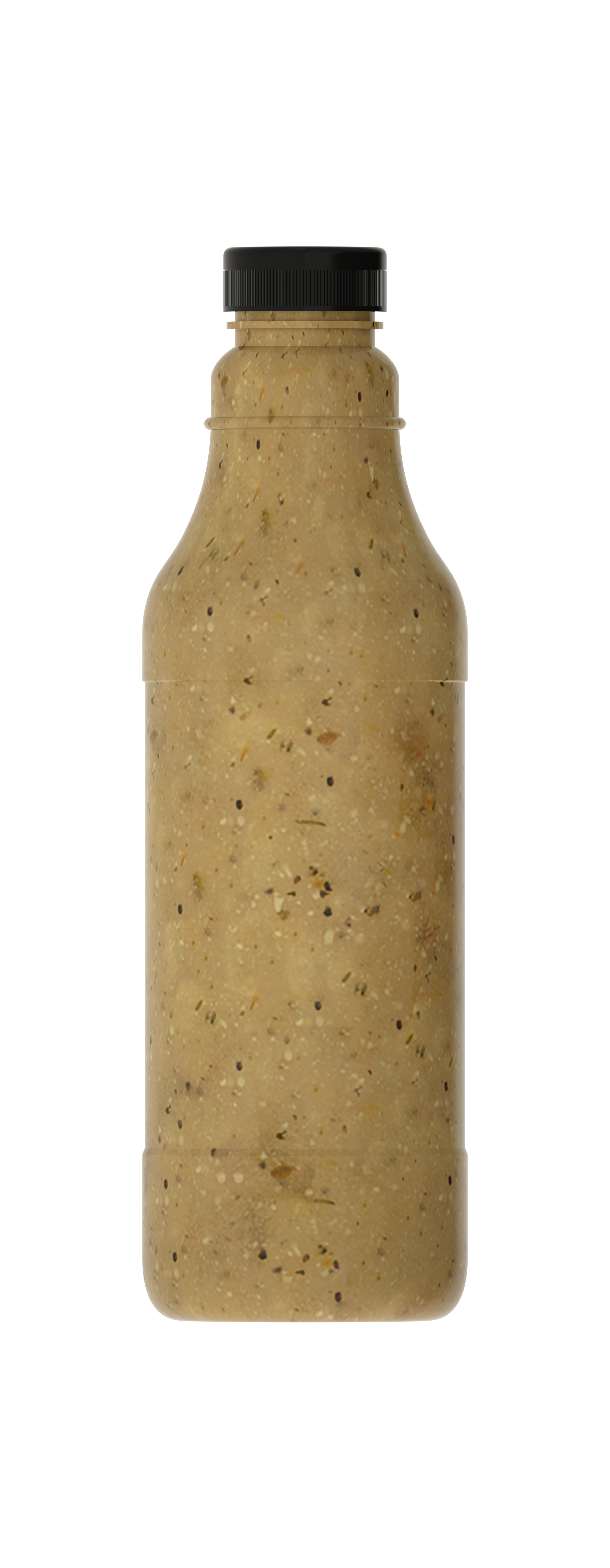

I am still struggling with this in respect to the 'clear film' channel, which has a marble texture in the example above.
Whenever I used a combination of glossy and glossy or specular and glossy, I cannot get the clear area of the label to have reflection, or in the case of specular, to not distort the contents behind due to IOR influence. So the container has opaque fluid contents and the label is clear and glossy, except where color is applied, where the ink is glossy.
-Rick

Hi reberts2,
.3dm file for you.
Regards
Paride

Ahh, I see now.
Thanks so much for your assistance!
