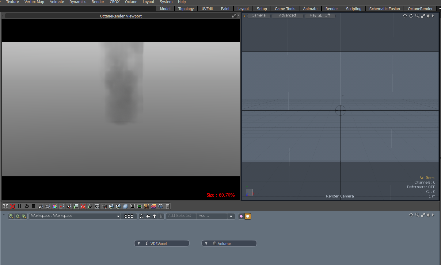

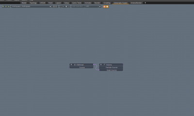

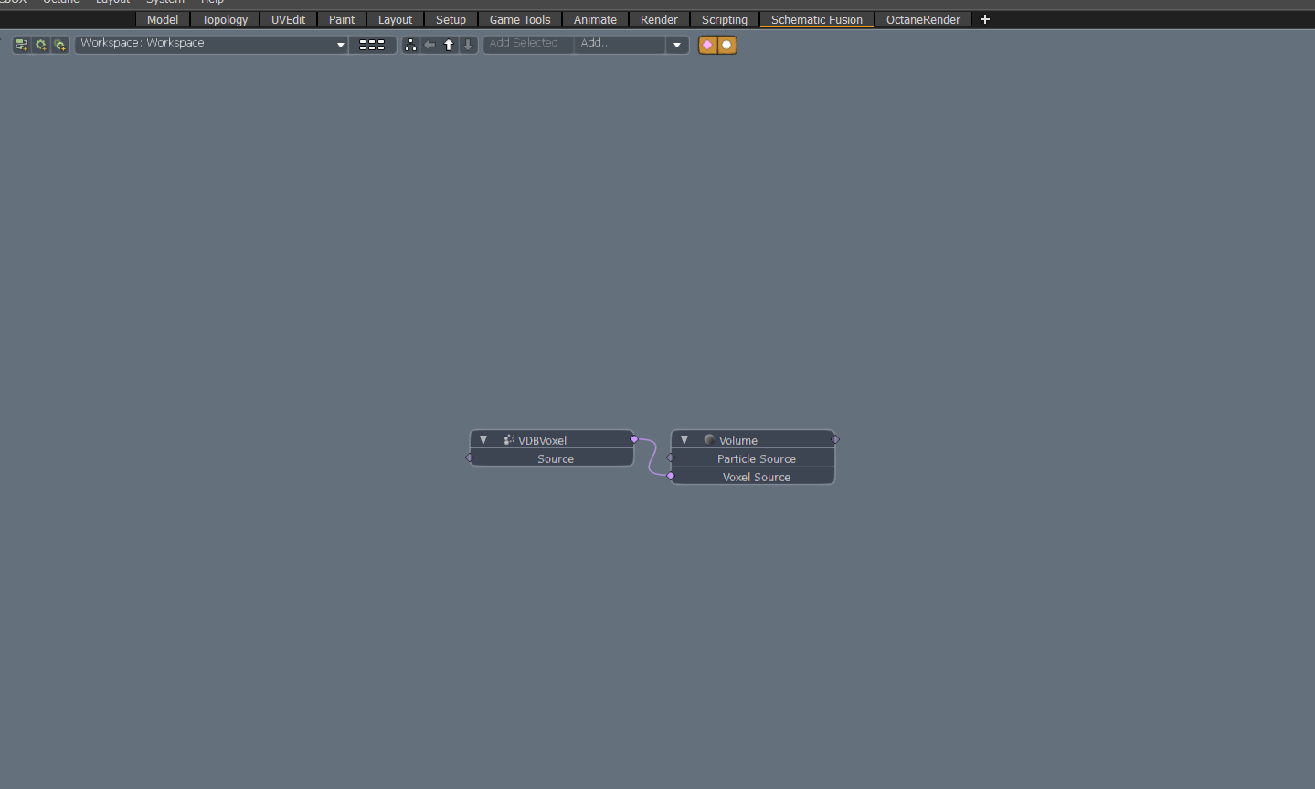

When i use vdb, i can't see and drag drop VDB Voxel's source channel in OctaneRender Layout. It can only Schematic Fusion Layout. And Volume's channels(particle source and voxel source) are too.
S/FLayout
S/FLayout
OctaneRenderLayout
OctaneRenderLayout
funk
Posts: 1207
Joined: Mon Feb 07, 2011 1:24 pm
Location: Australia
yaseunghee wrote:When i use vdb, i can't see and drag drop VDB Voxel's source channel in OctaneRender Layout. It can only Schematic Fusion Layout. And Volume's channels(particle source and voxel source) are too.
click this

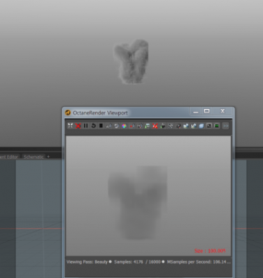

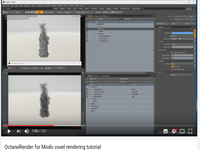

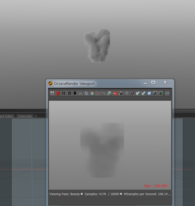

Why smoke in octane render is dimmer than Modo's it?
When i saw a tutorial video, both Octane's and Modo's are rendered same alike.
But when i render my vdb files in modo with octane, it looks vague.
If you use a VDBVoxel item in Modo, the plugin will read the number of grids from the first frame (which in the example you are using is a small number). So if you have an animated VDB which changes in size throughout the animation, you are better off using a Mesh Item OCS/ORBX proxy containing the VDB sequence than the Modo VDBVoxel item.

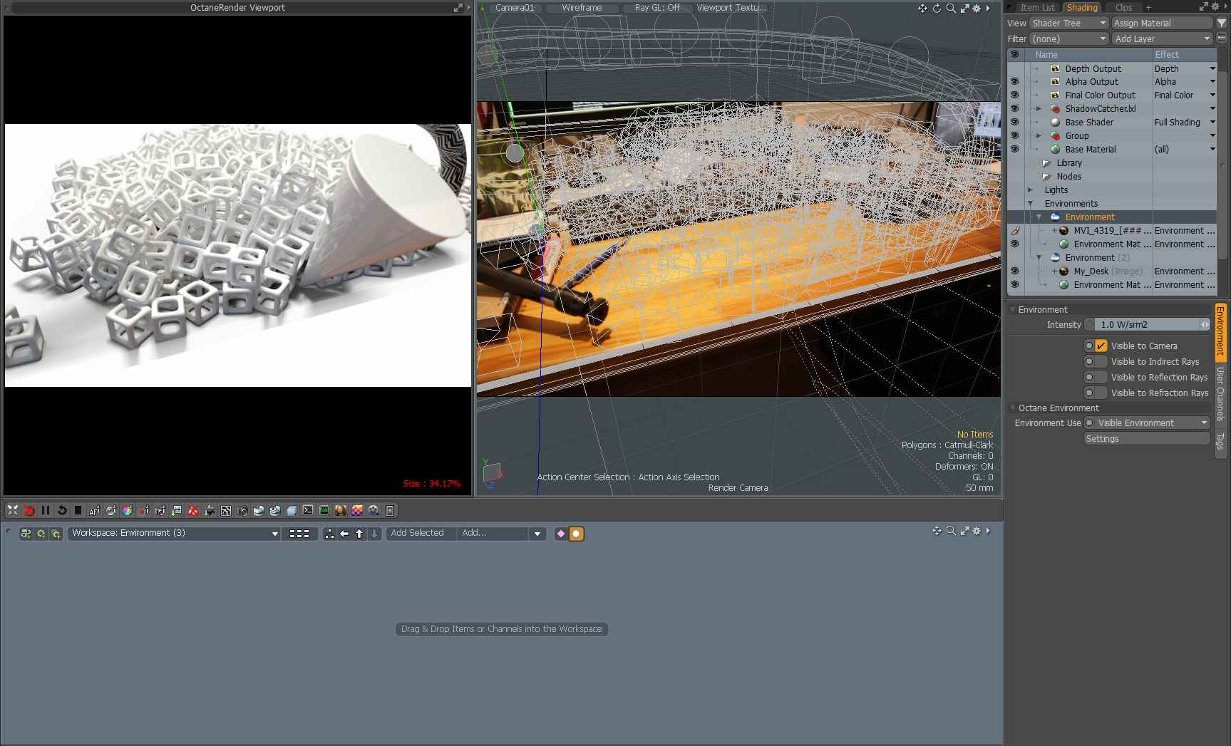

I want to use 2 environment map.
1 HDR map (projection type light prob)
2 sequential file(projection type camera projection)(live action image).
Would you please tell me How to use 2 diffarent environment map?
I already tested choose type of visible environment and lighting environment.
but, It's not works.(actually It' works,but light prob and camera mapping(sequential)is not works)
