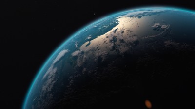

Hello. Faced such a problem. There are squares appearing on the render. Cinema 4d as main program . How to win? Scene attached
https://yadi.sk/d/pVq_O24l3JML86
Render artifacts

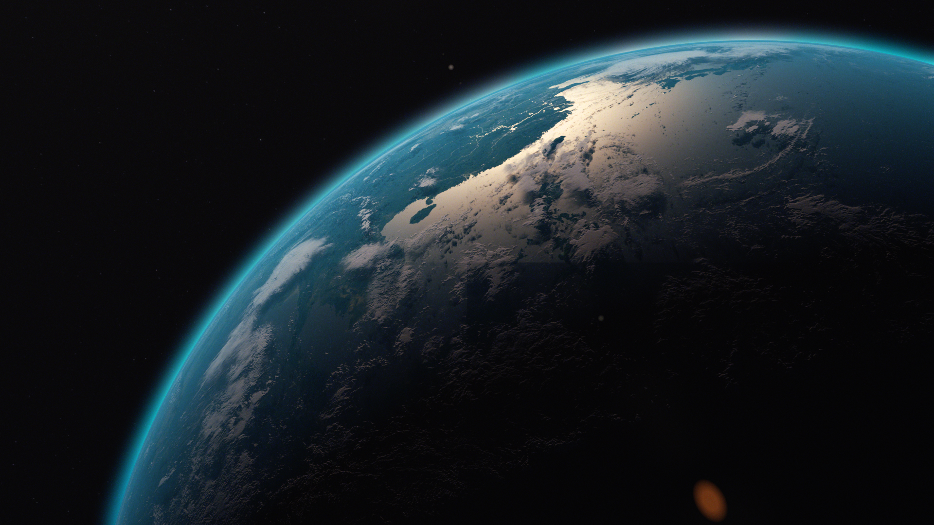

Hi superfox007,
if you are rendering with slaves, please, disable the Minimize network traffic option.
I have opened your scene, and you have a couple of huge textures without the Octane Image Texture node.
ciao beppe
