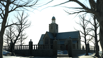

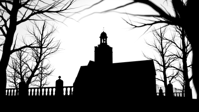

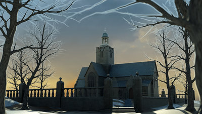

Attached are three pictures:
The first one is the alpha mask.
The second one is the beauty pass itself.
The third one is the composited one with a background sky picture.
If anyone have a solution how to get rid of that white rim (which was supposed to be the blurr + reflection area),
that would be more than wonderful.
ps. The corner at the alpha picture there's bit of vignetting. it's actually a sky color of blue. I have the sun direction
and lighting power remain exactly the same...and that's why there's bit of blue at the top left corner. If I change the lighting
to rgb texture instead, I can get the pure white background, but the degree of blurr in the edge would be different.
Thomas

There is several things you could do, first would be to add more contrast to the clip image playing with the tonemapper or the intensity of the background, another would be lowering the aperture also in the clip only, or at comp (at least in photoshop) there is this tool to eliminate white halos)

Hi Kubo thanks for replying.
I am not sure what tonemapper you refer to...is there a button called tonemapper?
Also, would appreciate if you can try solving the problem using those pictures I provide.
I asked my compositor friend and he said the "alpha map" I rendered out isn't really working with the image.

Its not alpha as it is...its emitation of alpha. And camera options also influence. Its not correct. Need fair alpha algorithm.

Foxid is rigth, this is just a "trick", true alpha maps are on its way, but in the meantime...
Well, what I meant is to render again the "alpha" one, and in the preview imager eliminate the vignetting, play with the exposure, and the rest of the values to get a more suitable image. Also in the enviroment set a higher power.
