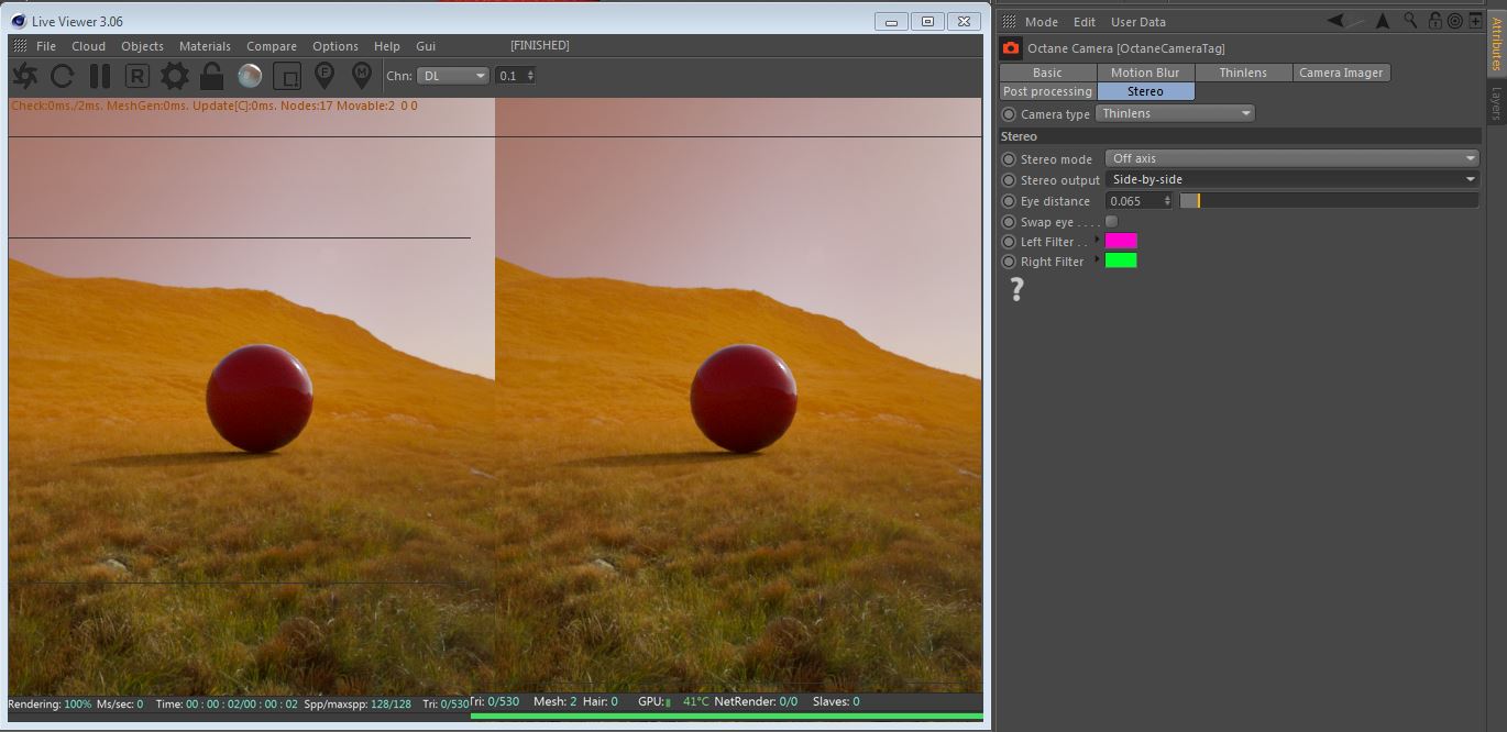

in the active Octane Camera Tag, go to Stereo Tab and choose between Side-by-side or Over-under mode, and adjust your resolution by dubleing the orizzontal dimension for SBS mode, and the vertical dimension for OU mode of your original frame resolution:
