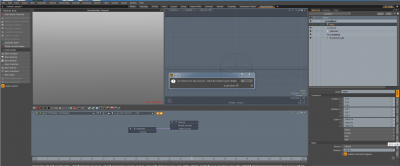

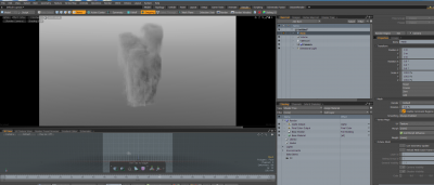

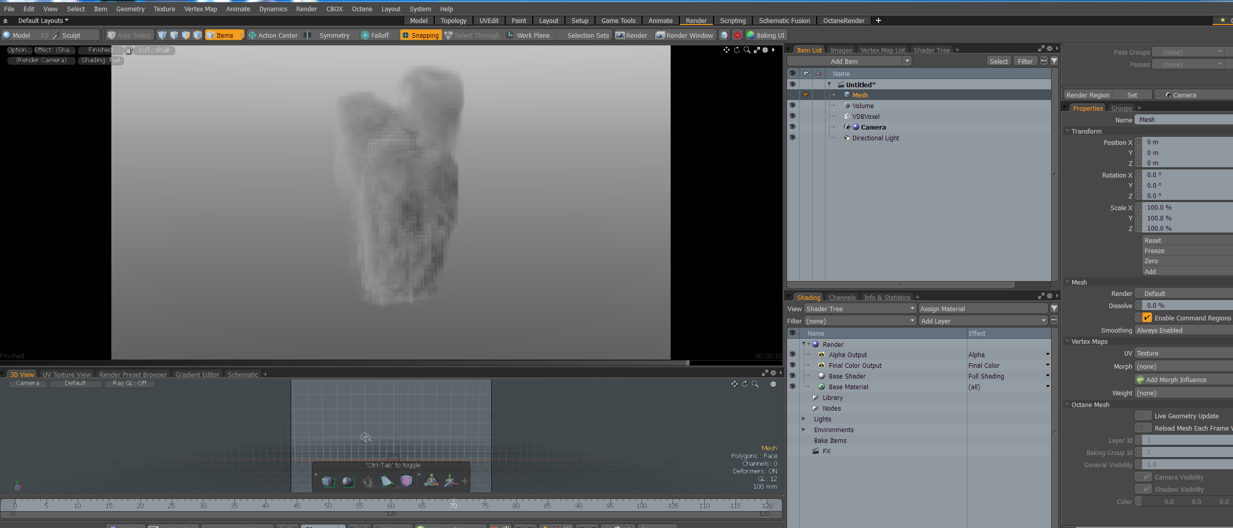

When I used Octane V3.03 and Modo 11, rendering openvdb files in modo render is normal but Octane is abnormal.
Now i use Octane V3.06 and Modo 11 when i render openvdb files in octane, it writes this message.
A first Image is render with octane but failed and a second image is render with modo 11.
render with Octane
render with Octane
render in modo.
render in modo.

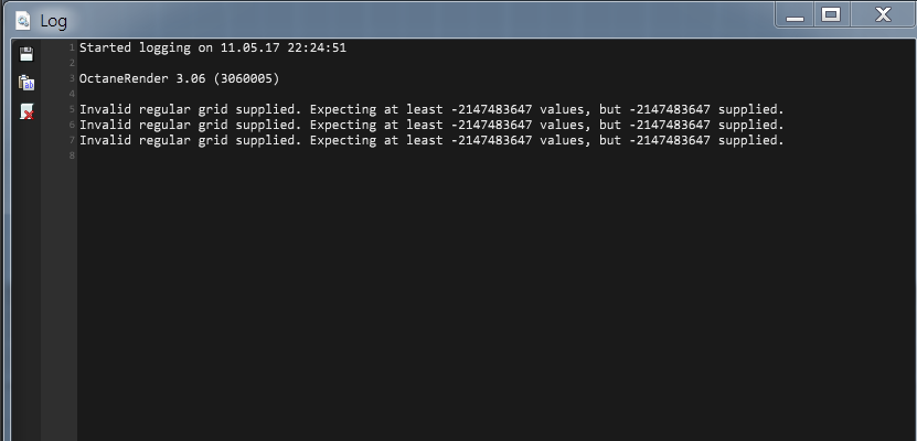

The error msg is saying to look in the Octane Log. What did the Octane Log say pls?
Paul
yaseunghee
Posts: 19
Joined: Thu Jun 11, 2015 1:45 am
Oh, I forgot attaching a log.
like this.
