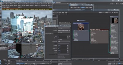

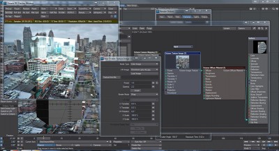

I can't help you with the TFD issues since I'm not a user, and can't really understand what you're trying to do with #4, but maybe I can help with #1.
I'm relatively new to Octane as well, and this took me a while to figure out. On the texture image node make sure you're u and V translate values are set to zero. Then it will behave like LW front projection image map.
UV Translate 100% UV Translate 0% Hope this helps, Good Luck!

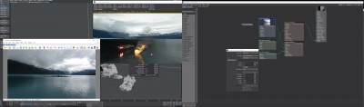

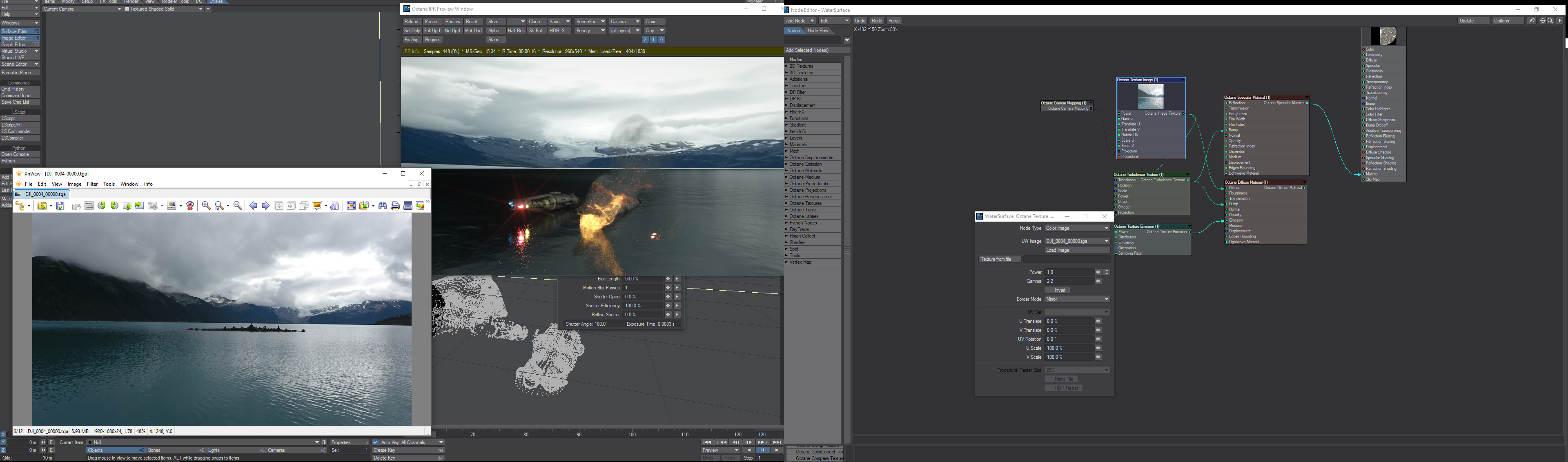

Thanks for the reply, though I am not sure that it is helping.Alteris3D wrote:Hi Bookmansblues,
here is a screen shot of what I am working with and the visual feedback I am seeing.
Look at how the BG image is larger than the visual output, and appears stretched in the X axis.
- Bookmansblues
- Posts: 9
- Joined: Thu Apr 27, 2017 1:15 am
it is so I can switch the material depending on which compositing pass I am working on.Alteris3D wrote:How come your diffuse material output is not connected to anything?
The diffuse material is matte so I can get the lighting off the surface of the water reflected off the 3D objects in the scene.
The way the material is set up now it is just for getting the reflections off the 3D objects in the scene in the water surface.
Hence question #4, I want to be able to capture those reflections without picking up the reflections from the environment, since in the footage those reflections already exist, and adding them again will make them unrealistically brighter.
OK, maybe I'm not being much of a help.  I don't see why your background image is stretched, the camera mapping node works as I expect it to.  As for  your water surface reflections, why not render that without the environment, wouldn't that give you just the spaceship reflections on the water?

No worries, any help is useful because it shows that the problem is probably less about my own ignorance, and more to do with something else. I am fully prepared to accept that it is about my own ignorance, but that comes with the terretory any time you try to learn something new.Alteris3D wrote:OK, maybe I'm not being much of a help. I don't see why your background image is stretched, the camera mapping node works as I expect it to. As for your water surface reflections, why not render that without the environment, wouldn't that give you just the spaceship reflections on the water?
but not the IBL from the image itself, sure it is not an HDRI, but it is better than nothing, and I can do a fair bit to make it look like it has the correct illumination in post.
That is something I can do in native LW without a problem by simply lighting the scene with the environment but switching the water surface to raytraced and spherical map, and leave the map input empty. As far as I can tell, Octane does not have an input for that, so I may be out of luck there.
I must check it again, but I remember a limitation related to the cameras to be used in the camera projection must have the same resolution aspect ratio that the main camera. Perhaps this is your problem. If you want to send me a sample scene with this issue I could test it here.
To render TFD sequences in update mode, you must enable the "Update Volumetrics" option in the render target root node options panel. Without this option enabled, the plugin will render always the volume from the first frame. Of course, you could also configure the render mode to "Full scene reload".
I'm not sure what could be the problem with the TFD shading. Usually, the problems with the emission are related to don't have a correct scale for the emission grid, or some kind of issue in the blackbody emission node, like have the "Normalize" option enabled. If you want to send me your TFD scene, I could test it here check the shading issues.
About the IBL lighting, I'm afraid that currently Octane doesn't allow exclude objects from lights, or from the textured environment. I'm not sure if someone has a workaround, but I suppose that breaking the scene into several layers and compose them in post can be one solution.
