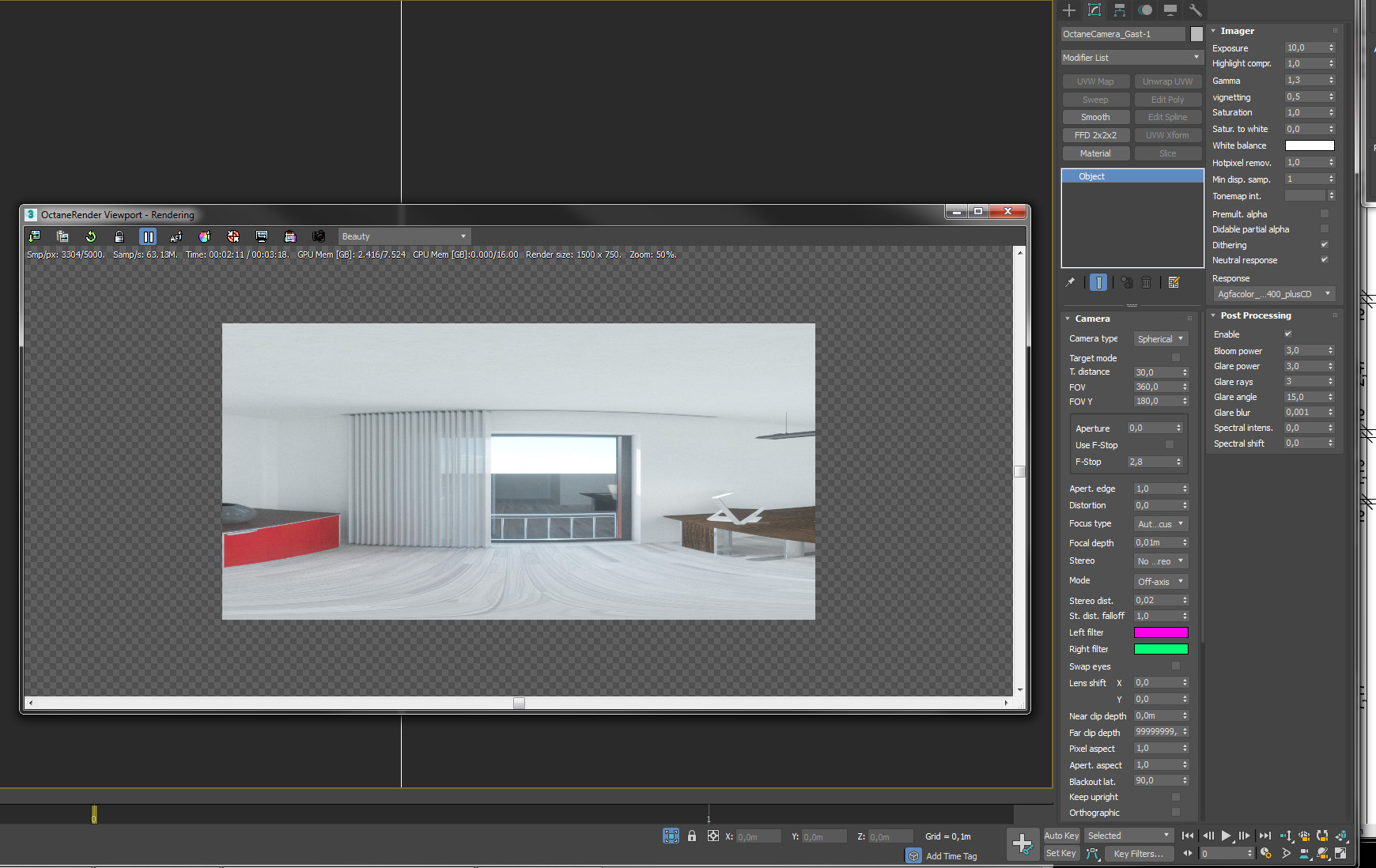

Spherical camera seems to be broken!
Same scene and setup with two different results compared to last version. I'm on a deadline with two vitual tours. Any chance of a hotfix?

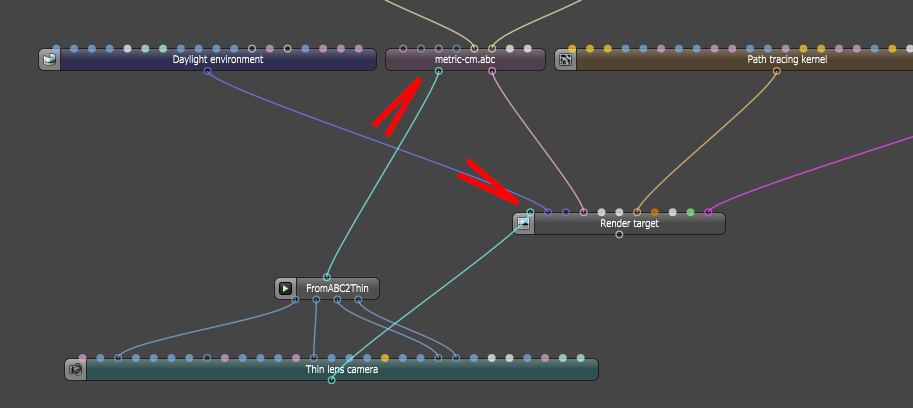

Hi mbetke,
I tested your issue, thanks for the report.
I've sent the issue to developers.
The workaround is to export your scene to Octane Stand Alone 3.06 using the attached luascript thincamera as in the screenshot.
Regards
Paride
Regards
Paride

For me temporary fix of this issue is to Enable "Keep upright" option in Camera Settings.mbetke wrote:Spherical camera seems to be broken!
