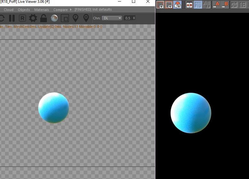

Can someone explain me why there is a difference between liveviewer and render window and how to get the same result as liveviewer which seem to have the correct light position ?
Lights are moved or rotated and I didn't understand why...

Disable "Pitch" and you will be fine.
