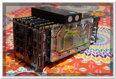

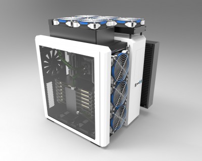

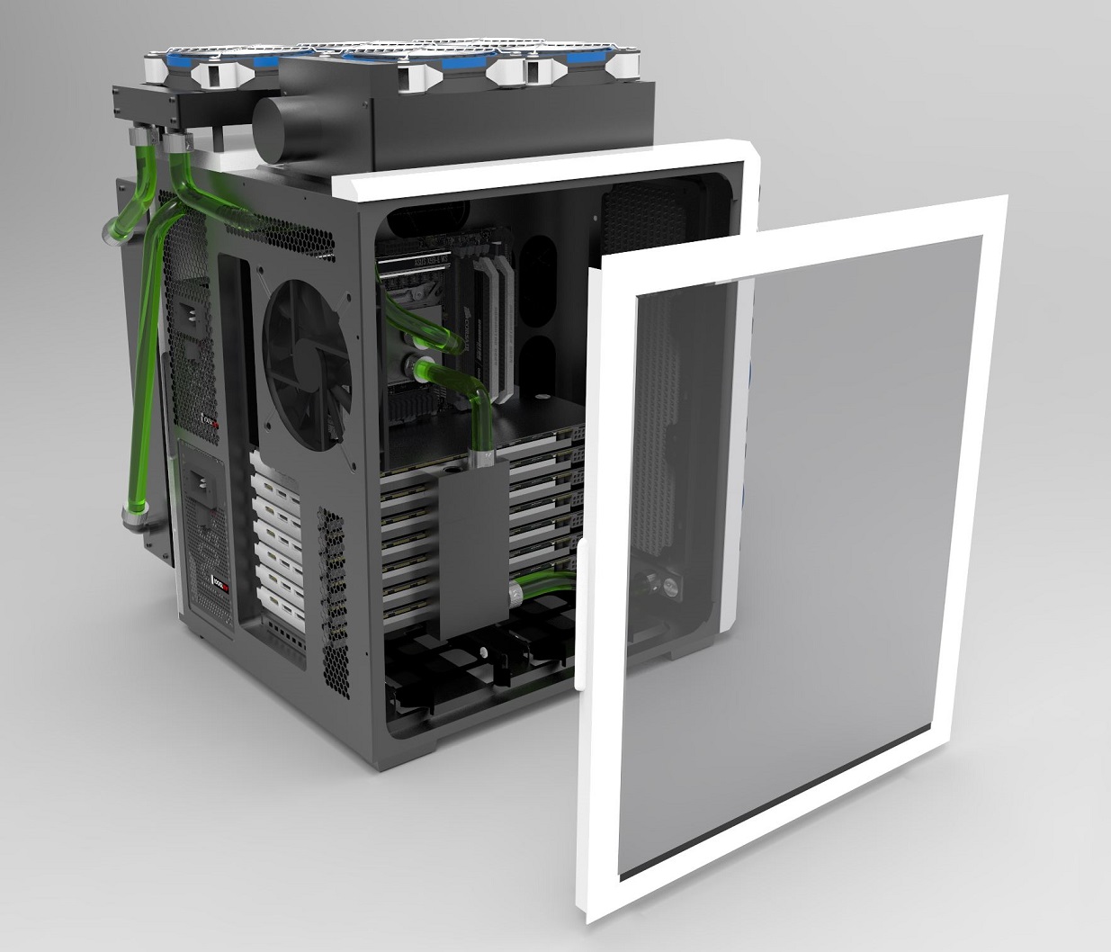

Here are some update of my 7GPU rig based on same motherboard.
Rendering preview (sorry in keyshot)
And mounting 7GPUs block and box

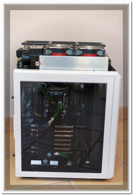

Final rig,
Tested and running OK.
Thanks to Smicha and Tom for advices.

Nice! What temps You're getting, Itou31?
so "7 is new 4"? =)
I mean before quad GPU was the best & now hepta builds seems to be the way to go!

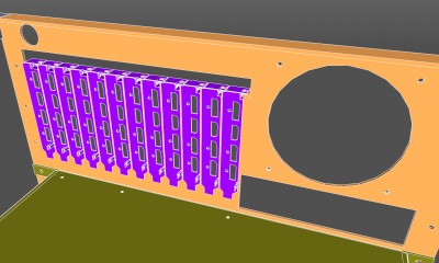

After one of my 7x gpu build I definitely recommend one more thing - due to super heavy weight of gpus - at least 5+ kg for waterblocks only horizontal mobo layout is very highly recommended for transportation. Moreover almost all available cases are made of thin 1mm steel and any shock to a case will bent backside where IO brackets are mounted.
Here is my sketch of upcoming this week 11 gpus in 3mm alloy case.

Vertical layout might be less of an issue if You use reinforced PCIe slots, but for shipping laying motherboard flatly is a must.
I've been shocked how much 4x Single slot modded GPUs weight - 7 of them is way too much to handle for fragile motherboard & crappy case (that were never designed for such use in the first place).

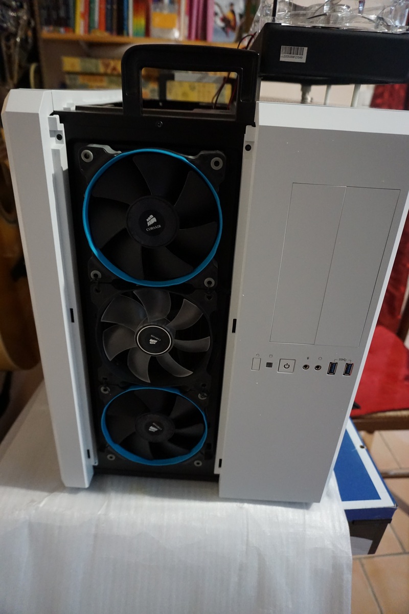

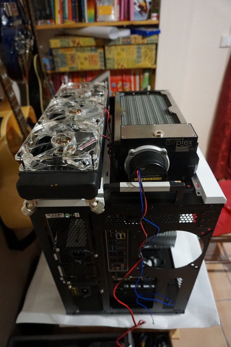

Yes, the weight of these 7 GPUs reminded me to make the reinforcemment under the hepta terminal (place to locate the octane logo).

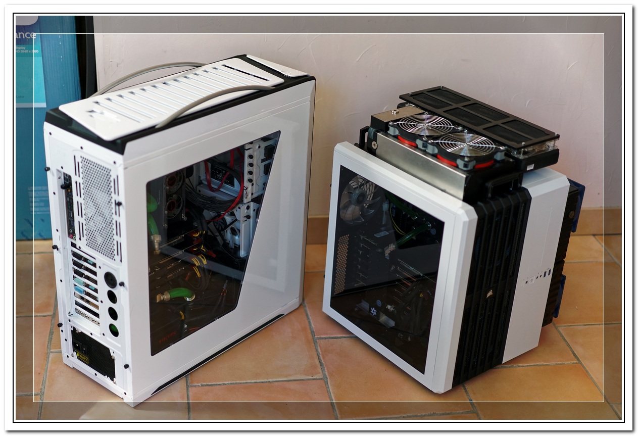

So temperature is better than my 4GPUs build. With ambiant temperature at 22°C, the max reached at an octanebench is about 47°C on the hottest GPU. In rendering daily task (PT kernel), up to 50°C, but ambiant is hotter too.
here is my old "4" beside my new "7"
