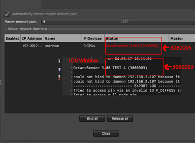

Netrendering doesn't work due to the fact that the version numbers are different.
I tried the newest C4D Plugin and the version number is 3060003 but i need
3060005 which is the corresponding "Octane Render number".
Where can i find the right C4D plugin?
Cheers
pete

petesand wrote:Hi,
Cheers
pete
It's different because you're using test4 version of standalone. Update your standalone not C4D plugin.
