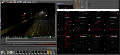

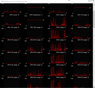

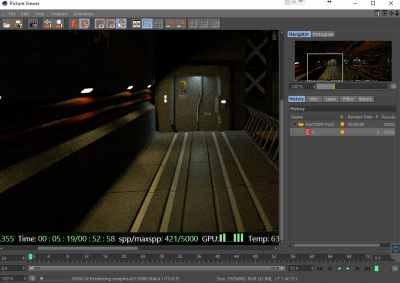

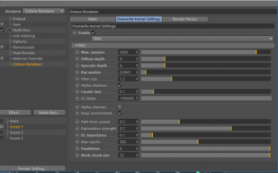

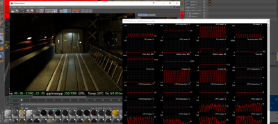

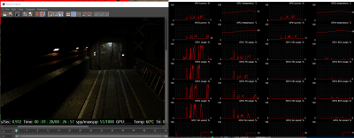

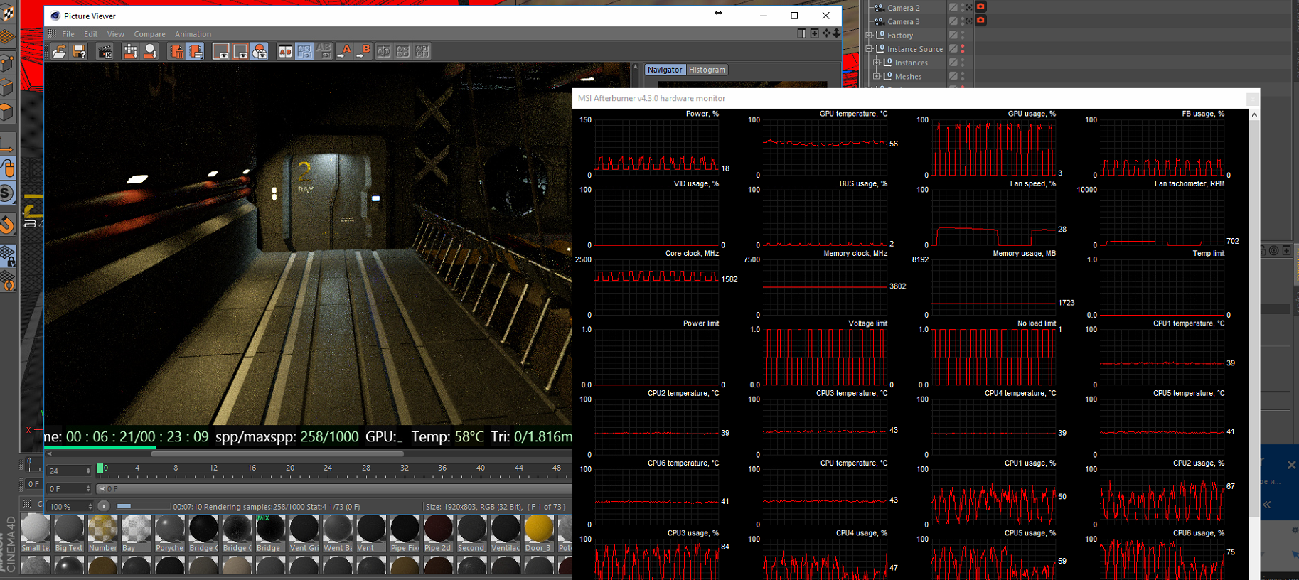

I'm working on pretty complex scene in C4D with a lot of different lights and glossy mats. I chose to go with PMC to get rid of hotpixels in PT. I thought that some extra rendering is not a big problem as I have 7x1070 GPU farm(PC2)...but here's the thing..it's slower on PMC algo than 2x1080(PC1).
This problem only appears in PMC algo, so I don't really understand what is the problem.
PC1:
  • i7-4790k
    32GB RAM
    2xMSI 1080 gaming x
    SSD win8.1
PC2:
  • Xenon E5 2609v3
    64GB RAM
    7xMSI 1070 gaming x
    HDD win10
Here's few screenshots:
PC1 stats
PC1 stats
PC1 GPU usage
PC1 GPU usage
PC2 GPU Usage
PC2 GPU Usage
PS2 Stats
PS2 Stats

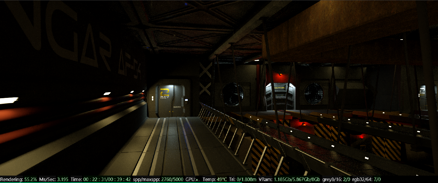

Render Settings
Render Settings

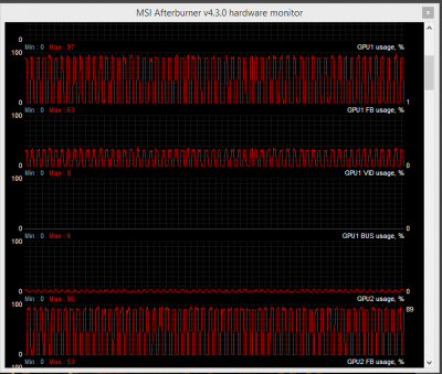

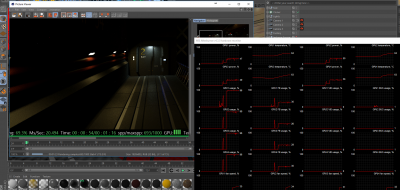

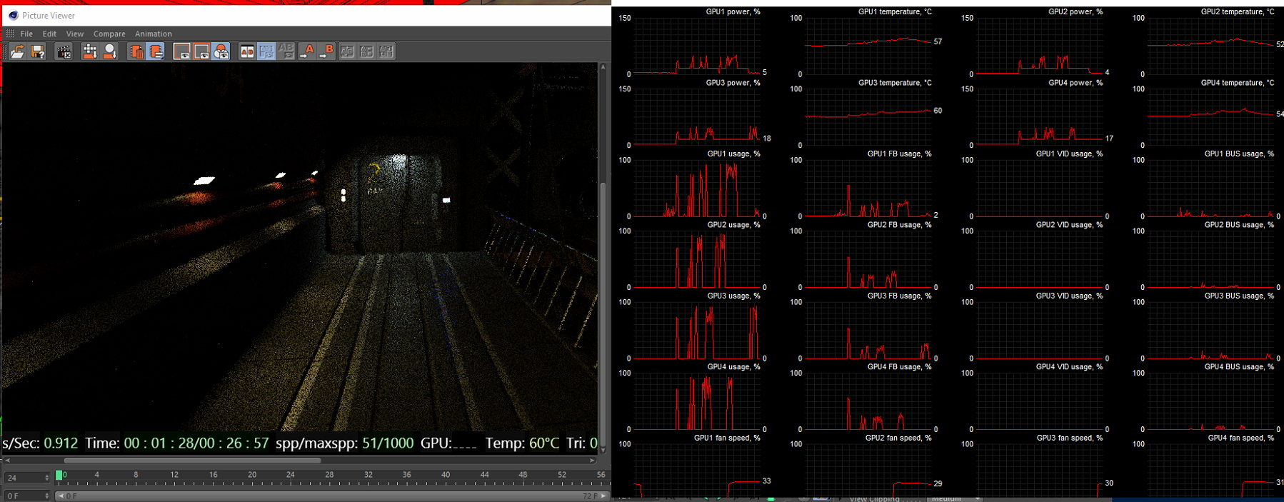

Tom, I've removed x1 extenders and.....the picture is still there :(
1gpu in mobo, 3 on ribbon risers. I don't understand why it works so bad in PMC_MP only...
Here's the graphs with 4 pgu and 1graph with 1plugged gpu only:
PMC_MP
PMC_MP
PMC_noMP
PMC_noMP
PT_MP
PT_MP
PT_noMP
PT_noMP
1GPU_PMC_MP
1GPU_PMC_MP
