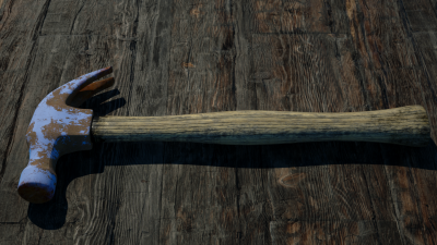

I haven't done much with metal as well. I did do this hammer but it's all painted and rusted so no metal.
I did this through standalone, not Blender. It was just a straight up plug in the texture, nothing fancy.
