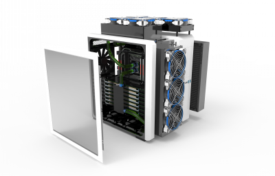

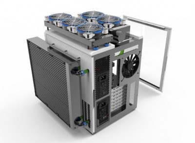

itou31 wrote:
@ITOU31, one thing..keep in mind REUSED AIR. What do I mean about that, well, with 360 in front that 240 on top would loose quite a bit of it's efficiency. I made some tests with 240 front + 240 top (that reuse air from front rad) & in case of closed case there is quite a bit of a difference.
Honestly, I would really consider MORA rad - one external piece instead of the mess with multiple small rads, but I see why some might not be so much into it. Just an idea ;) ignore if it seems stupid for any reason.

glimpse wrote:
itou31 wrote:
The attachment pc_full.62.png is no longer available
Yes, you're right, I should consider low pressure inside the case for better "cooling", so I think to manage more airflow on extract (2 fans on top and one rear).
Else I have a big phobya 1080 on the other side with some low airflow fans.
