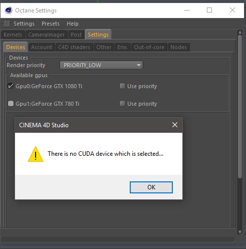

It appearance that Octane v2.26.1 does not supports Nvidia GTX 1080 Ti or maybe is my computer?
I have 2 video cards: 780 Ti and 1080 Ti. but octane only uses the 780 Ti.
When i try to use the 1080 Ti this shows up (see image)
Any idea?

*It does not support 1080ti\1080\1070, because they use 8.0 CUDA and Pascal architecture, for all I know Octane supports it only since 3.02 version.*
UPD: it seems I was wrong, sorry.

Hi tonyM1,
did you update the nvidia drivers with a clean install?
v2.26 is the only v2 version with Pascal support.

bepeg4d wrote:Hi tonyM1,
ciao beppe
Yes, Nvidia drivers are updated.
Octane standalone (2.26) does support/uses my 1080 ti, only the C4D plug in doesn't.
