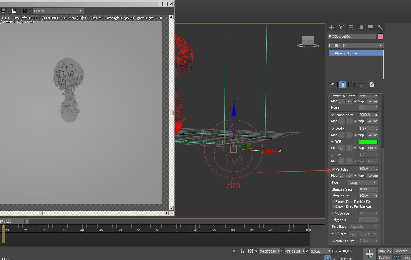

1. Add Octane Particle WSM to Phoenix container
2. Enable Particles in the PHXSource Object
3. Create a Sphere or any other Object and copy the name into the Octane Particle WSM "Particle Mesh Node Name"
and Render
Looks like this

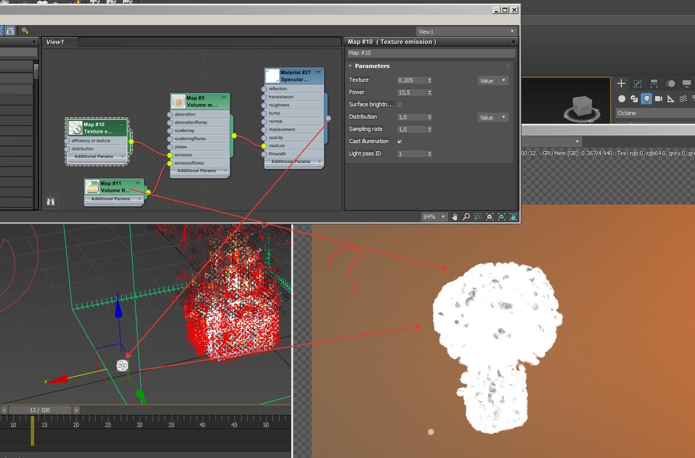

+ emission ramp not work
fume fx VDB

i didnt add any map to the sphere.. just added a octane volume modefier to the Phoenix Object in adition to the Particle object.
Currently rendering a low res sim to see how the motionblur looks on particles.
