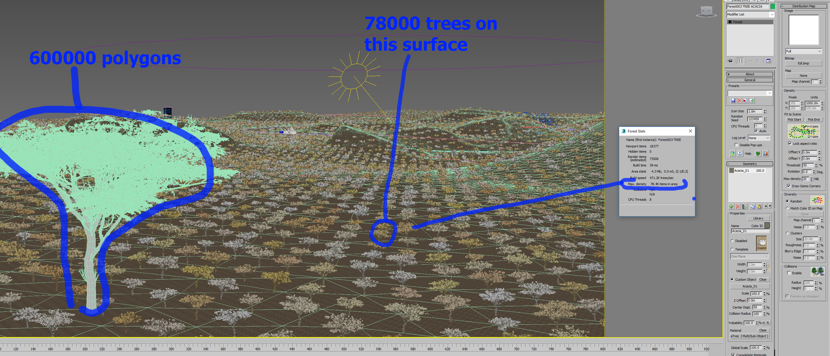

here is an example where we have over 78000 trees in the area . This tree is 600000 polys. So it is over 46 billion of polygons of itoo forest trees and we are only using 0.2 mb of vram. So you can easily scatter 5-6 trees like this and have a nice forest and only use 1 gb of vram. The rest can be used for other things.
Make sure original trees etc are hidden as a hidden layer when rendering. Only itoo forest enabled. and i would not use octane proxy with itoo forest. just bring 5-6 trees to the scene, let itoo forest add them to custom objects and then hide those original trees as a layer
i would not recommend scattering trees with poly count over 1 mil.
