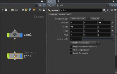

I'm wondering if there is a way to create grid facing direction/location of viewport “camera”, similar to what happens when I cntrl click on Area light. It could be a new plug in feature, and would be very helpful. Thanks!!

You can create a grid and parent it to the camera (connect the nodes in /obj). Check out the attached screenshot.
