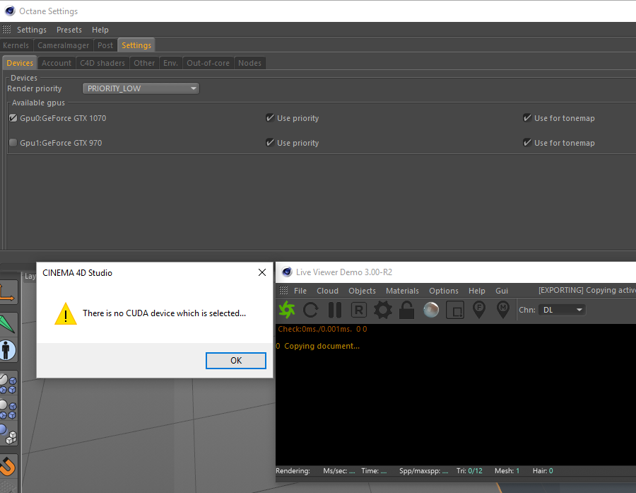

Here's a screenshot:

Hi Deltaproxy,
v3.00-R2 is a very old version, when Pascal GPUs were not yet been released. Please update your plugin at v3.05.3 and try again, thanks.
ciao beppe

bepeg4d wrote:Hi Deltaproxy,
ciao beppe
Thanx Beppe!
you were right. not even the right plugin for R18 was in my download.. i did downloadit not from the international website but from here infact : http://www.octane.it/,
and they still not have updated the plugin for c4d..
