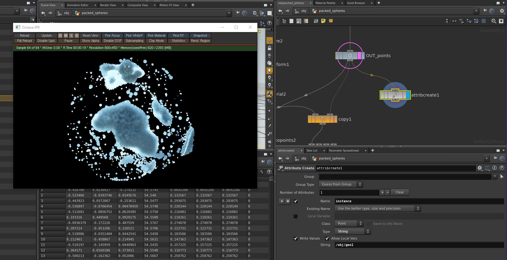

Oops, I probably didn't leave the example session in a sensible state. I've attached a copy of it in the present copy stamp based state with this reply. Below you'll also find a video link showing what the effect looks like. Basically, there is an animation going on in the scene, and pretty much nothing is visible in the very first frames but then it quickly builds up (POP & DOP net driven animation).
Below you see what the output presently looks like, rendered with OctaneRender, with the output being produced from a copy stamp SOP instancing circles. I was hoping there'd be a faster way still with packed instances via the copy SOP (in the current form where the shapes being rendered are spheres, I am aware I would be able to create this effect with the particles, but I was hoping to go for a more complex being instanced still once I get the basics right):

Use the Copy SOP is not a good idea at all for instancing. The Copy SOP is seen from the scene point of view like a node that adds copies of the object, not instances, so the full geometry is expanded at extraction time, without instance the master object.mz2 wrote: Below you see what the output presently looks like, rendered with OctaneRender, with the output being produced from a copy stamp SOP instancing circles. I was hoping there'd be a faster way still with packed instances via the copy SOP (in the current form where the shapes being rendered are spheres, I am aware I would be able to create this effect with the particles, but I was hoping to go for a more complex being instanced still once I get the basics right)
You can instance packed primitives, but using the standard instancing tools, like the Instance OBJ node, or the "instance" string point attribute pointing to the master object. The Copy SOP is only seen as an instancing tool by Mantra at render time.
