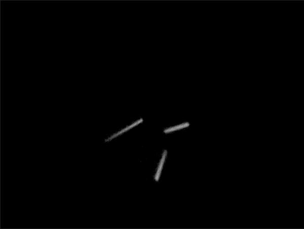

How did you get light pass 4 to look like this ? Did you do post work on it in PShop ?
How did you get around not using render masks ? You have them in PShop file so I’m confused ?
Cheers.
Light Pass 4 -

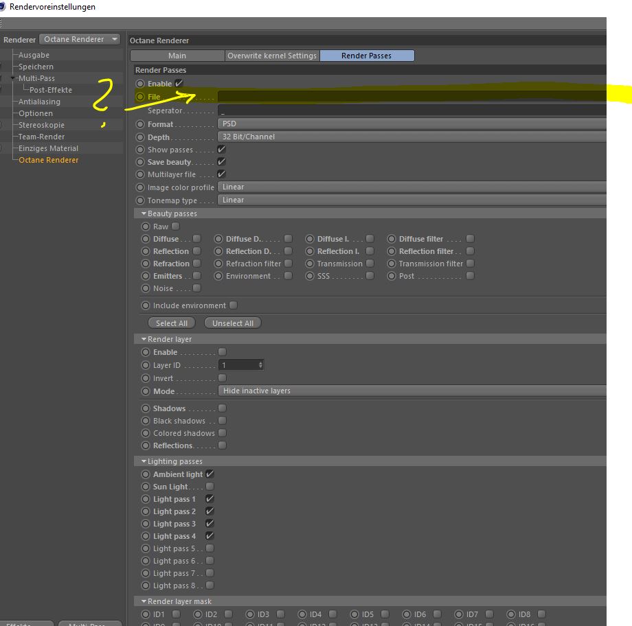

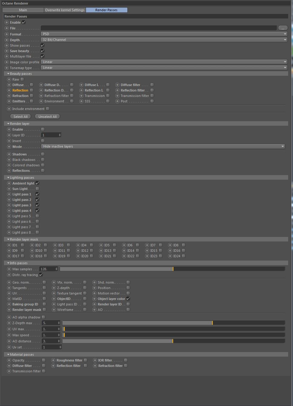

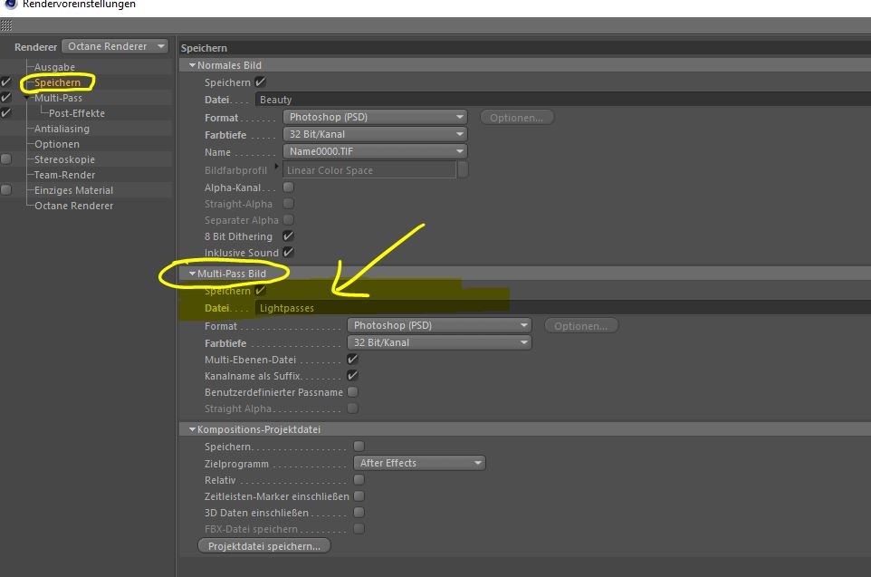

I rendered your scene with your render settings. Here -
But I also switched on Diffuse / Reflection in Beauty Passes.
Asus Sabertooth X79, i7-4930K, Corsair 32GB, 1080 TI Hybrid, 2070 Super hybrid,
Win 10, C4D R19.068, Octane 4.05-R7

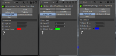

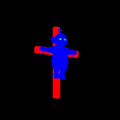

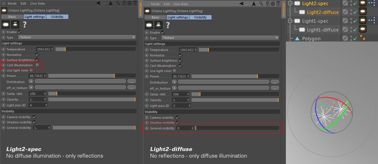

Hi andrefry
I'm currently extremely busy to go into more detail but maybe screenshots could clarify things a bit.
andrefry wrote:How did you get light pass 4 to look like this ? Did you do post work on it in PShop ?
There are four lights in that scene. I'm using separate lights in order to get reflection and diffuse light separately. That's how i can get a lightpass with reflections only.
There are other ways, using reflection and diffuse passes but it was easier for me this way. Also you can do some interesting things using that trick even without using passes so I was just anxious to show it to someone. :)

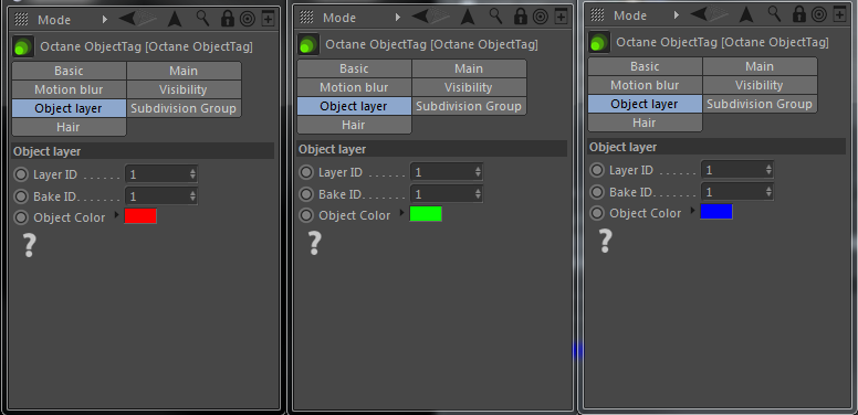

andrefry wrote:How did you get around not using render masks ? You have them in PShop file so I’m confused ?
Pay attention to how object tags are setup in that scene. I'm using object layer color to make a single pass that contains 3 masks, each in a separate RGB channel. In the PSD file I just created variations to show what can be done with them. I just copied each channel and used it as a layer mask.

miohn
Posts: 783
Joined: Sun Jun 06, 2010 3:00 pm
Hi MIlan,
interesting workflow!
I've got one question:
why do you save multipass in c4d-multipass and not in Octane?
I thought we've adviced not to use the c4d multipass saving.
Is there any reason for this?
thanks
Mike
milanm
Posts: 261
Joined: Tue Apr 30, 2013 7:23 pm
Hi Mike
Yes, you're right, that is not recommended. The only reason I used it was because layers were arranged the way I needed them by default in PSD. LV was saving an ugly 8bit mess and I was in a hurry. Also I work in scene linear untonemapped and didn't need alpha.
Regards
Milan

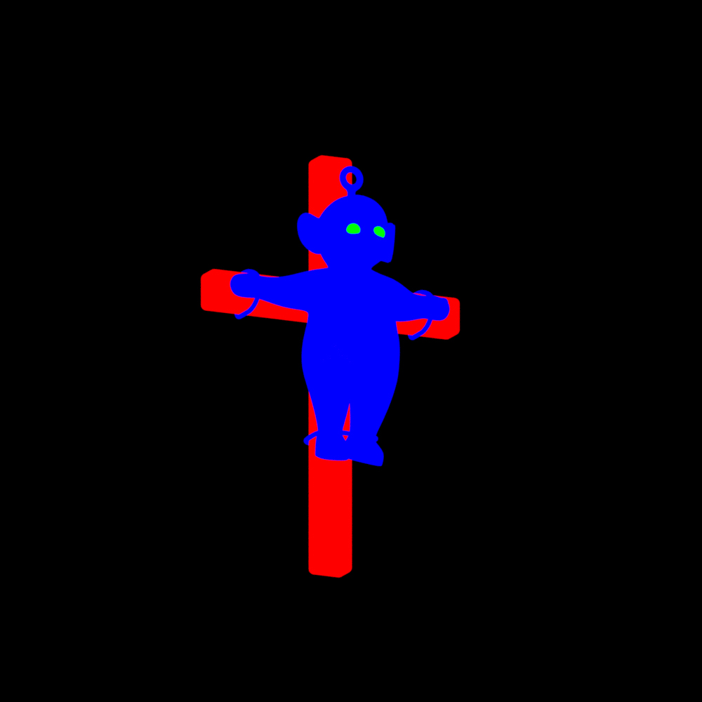

Hello there, I'm sorry if my post isn't appropriate as it is a photoshop related one but as I used milanm's great technique, I guessed I'd ask here.
I run in a mask problem in Photoshop.
Here is the colour object ID I made :
But when i group the layers with each object ID channel as a mask,
Screen Shot 2018-03-18 at 18.16.11.png (10.36 KiB) Viewed 6389 times
I get some edge noise like this :
Is there something wrong with my technique ?
I can provide files if anyone is interested in helping me.
Thanks in advance.
Edit :
Never mind, I also asked on stackexchange and found a solution.
For those having the same problem, here is the link.
