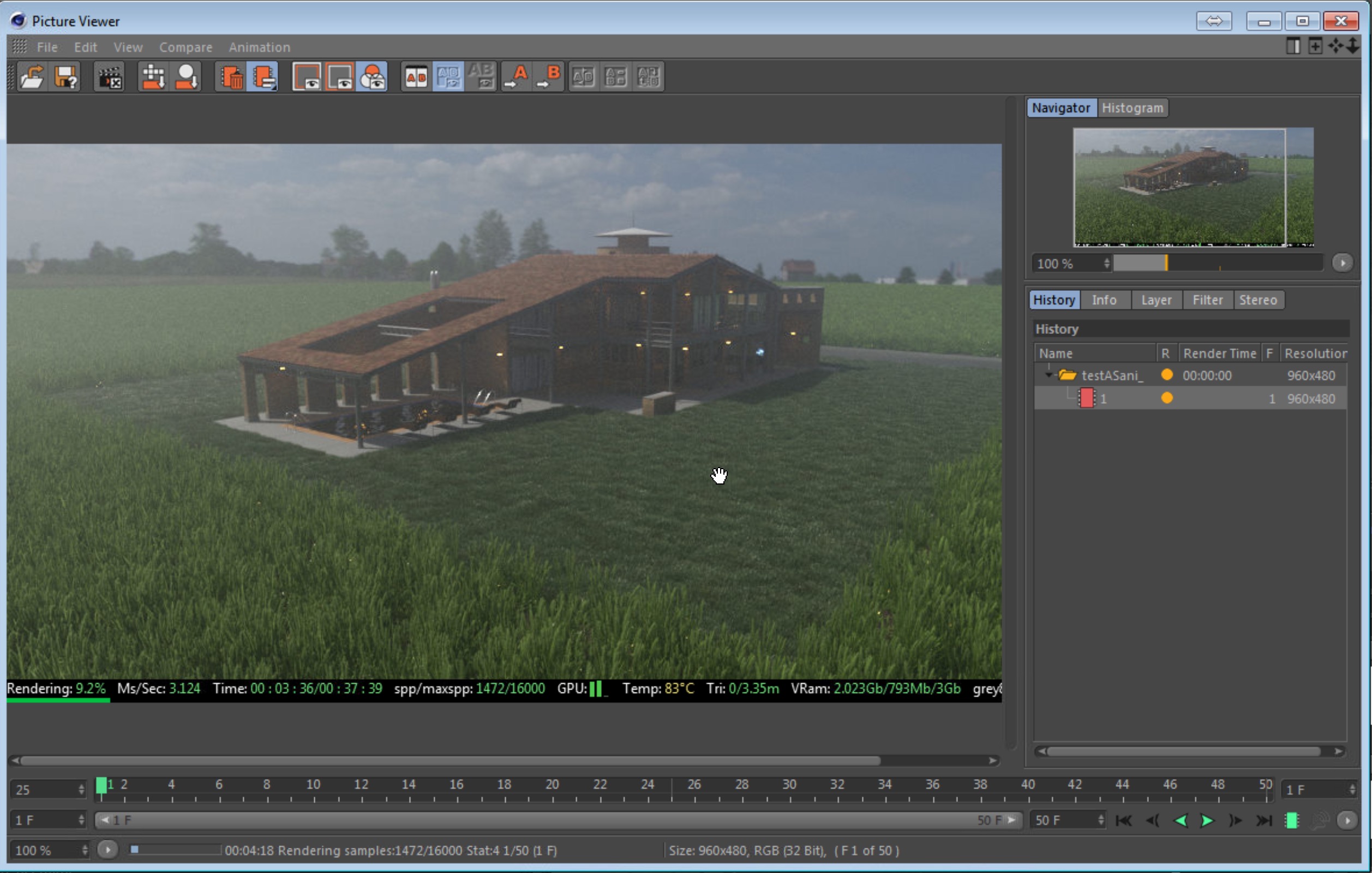

yes sure, it works exactly the same between LV and PV, unless you have a different setting in the Overwrite Kernel Settings Tab in Render settings.
Look at this example:
At the beginning, max sampling is 3 and the final time is 37min.
while, when AS enters in action, the max samplings goes to 134, and the final time drops to 6min.
Probably, because you cannot switch back and forth between beaty and noise pass like in LV, you are feeling that AS is not working.
You can enable the noise pass in the Render passes settings and save it, if you see some green pixels, then everything is working as expected:
