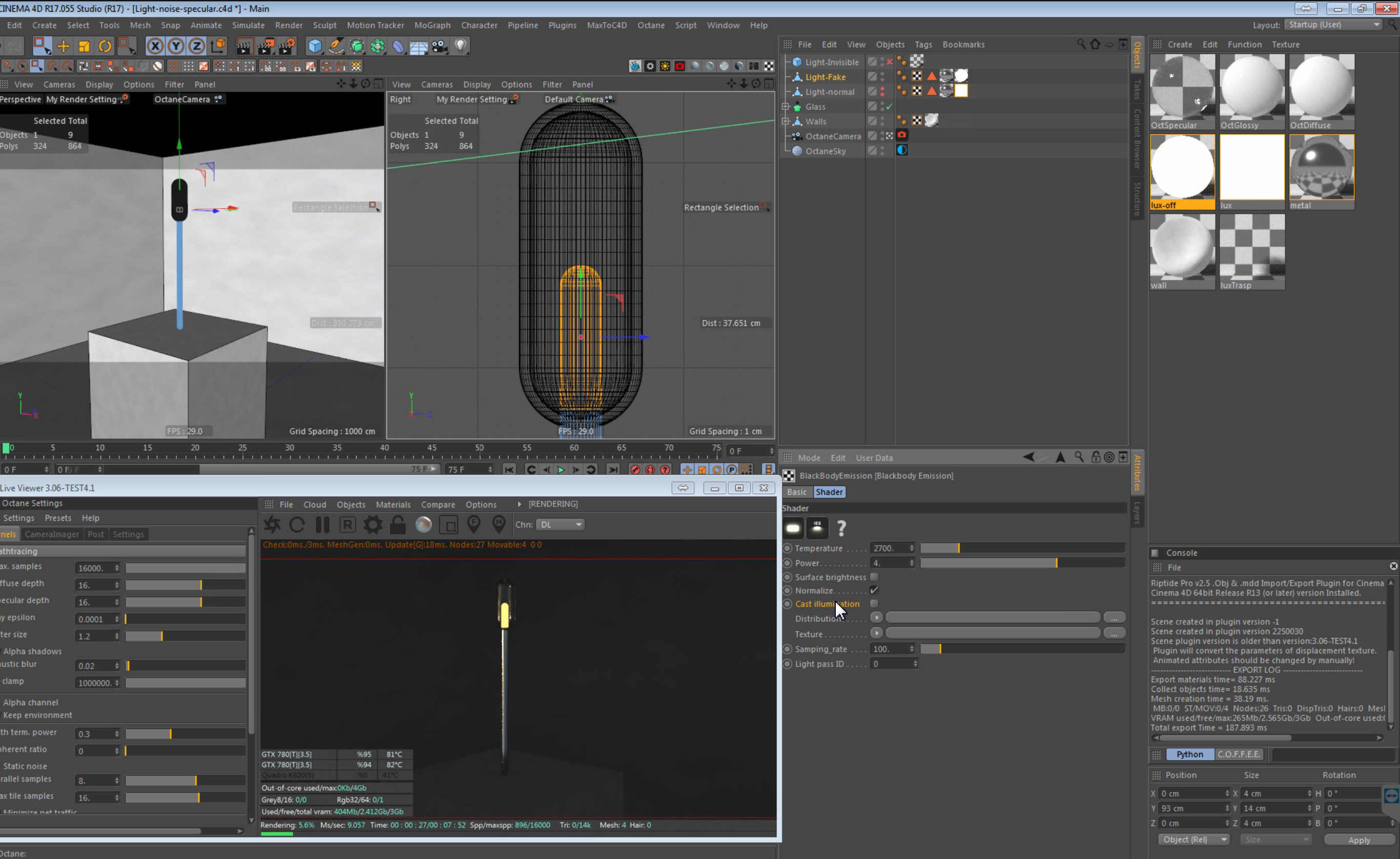

Look at this example in c4doctane, but you can do the same in any plugin:

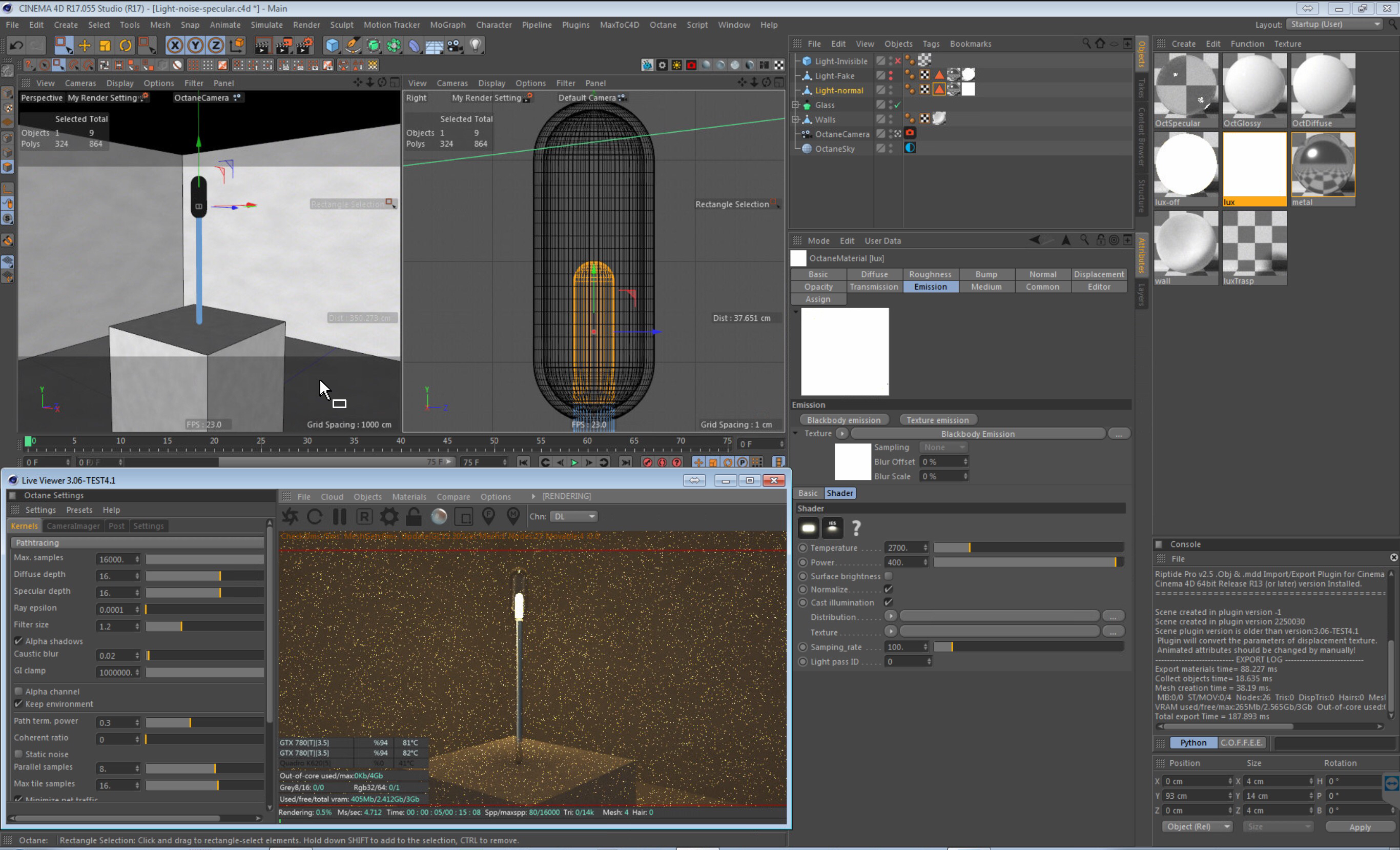

1 - Light with fairly complex geometry inserted inside a glass envelope - the noise is very obvious and you need a long rendering time before being able to clean up the image.
2- The trick is to disable the emitter lighting inserted into the glass, by unchecking the Cast illumination option:

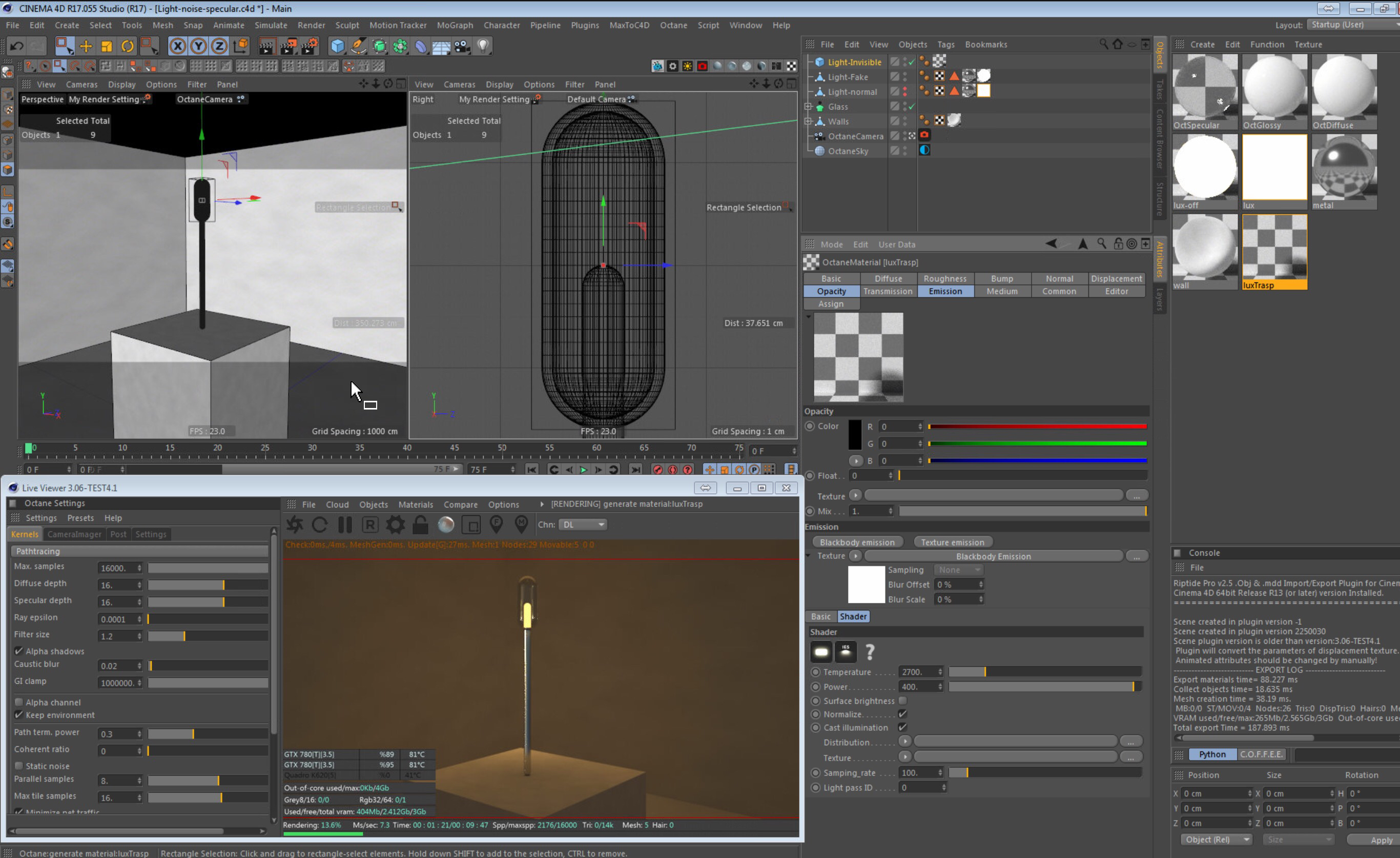

3- then create a very stylized geometric shape that overhang the glass, assign a new emitter material, and make it invisible bringing the Opacity value to 0:
in this way, you have zero noise even after just a few samples, and you can control the illuminating internal power separately, in order to obtain an even more realistic effect.
