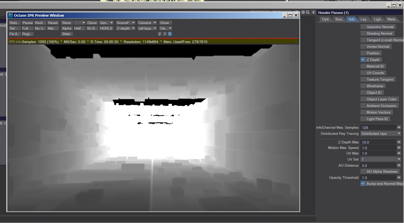

I need explanation on the Zdepth setting.
Z depth Max, ok but what? Cm, m, other? My Z depth is always white, idem Alpha !
thank you in advance

I suppose that in the LightWave case the units are meters. Anyway be aware that the zdepth is a floating buffer, what you can see white in the preview window, can hold floating values above 1.0 that are also valid for compositing.

Ah Ok ! Thanks JuanJo !
