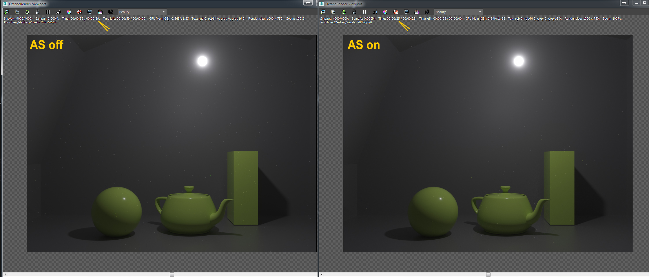

Hmmm.
Can you tell which is done with AS on?
Noise threshold .08
Group pix 2x2 (what difference does this make?)
Expected exposure 1.0 (what difference does this make?)
Min adaptive 20
Both cooked for 6 minutes at 3500x2625
Am I missing something here?

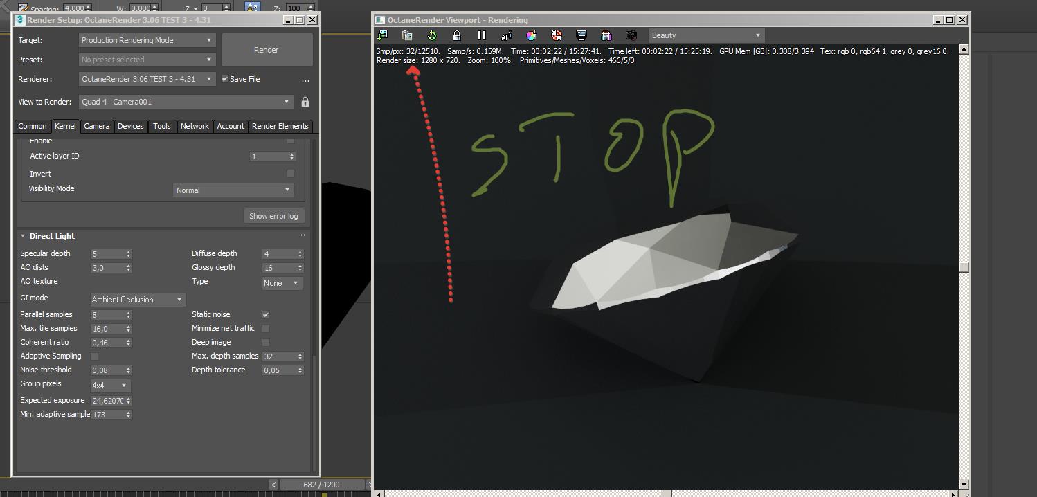

sorry but I can't. TEST ==== fixed hang !!!! down 4.30
you have given us to play with a broken toy :) :evil:

Hi Rik,
AS works by concentrating render cleaning where the noise is.
In potentially high noise scenes, AS reduce calculation times.
Regards

Thanks Paride.
I honestly appreciated the efforts you're putting in but...
I'm currently making multiple adjustments to the 4 variables and having to produce many, many tests to try and check that the grey parts are turning green quickly so Octane can work on the bits I know are going to still be noisy.
Its a real balancing act/guessing game though. For instance, if I go too high with the noise threshold it does not spend long enough on areas which are still noisy and will turn them green when in fact they're still noisy.
Too low with the noise threshold and it spends too long on bits with no noise.
Guess my point is that if its going to take 2 hours to get the 4 variables right for each image, then what's the point of it?
I'm running the tests at 3500x2625 so it's taking around 3 minutes each time to see what effect the tiny adjustments I'm making are having.
Please tell me I'm doing it wrong and there's an easier way?
