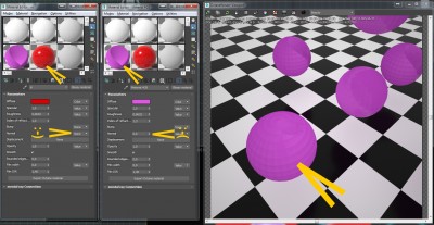

just installed and loaded the last scene with glass inside from previous release kernel - which looked fine before, same bug in the material preview as mentioned previously... sooo.. no good?
EDIT: found a solve - the normal has to be set to None - on any value, even 0 there seems to be some distortion - you guys maybe missed something, not sure if it was set to something else before, but do check out those normal settings for distorted materials
- probably should make it so there is no input when the "Normal" has a "Value" applied to it..

Hi Guys,
I've already posted about the material issue:
viewtopic.php?f=80&t=60450&start=10#p309264
A TEMPORARY WORKAROUND: WHEN THE NORMAL SLOT MAP HAS VALUE 0 OR > 0 THEN SETTING IT "NONE".
Regards
Paride

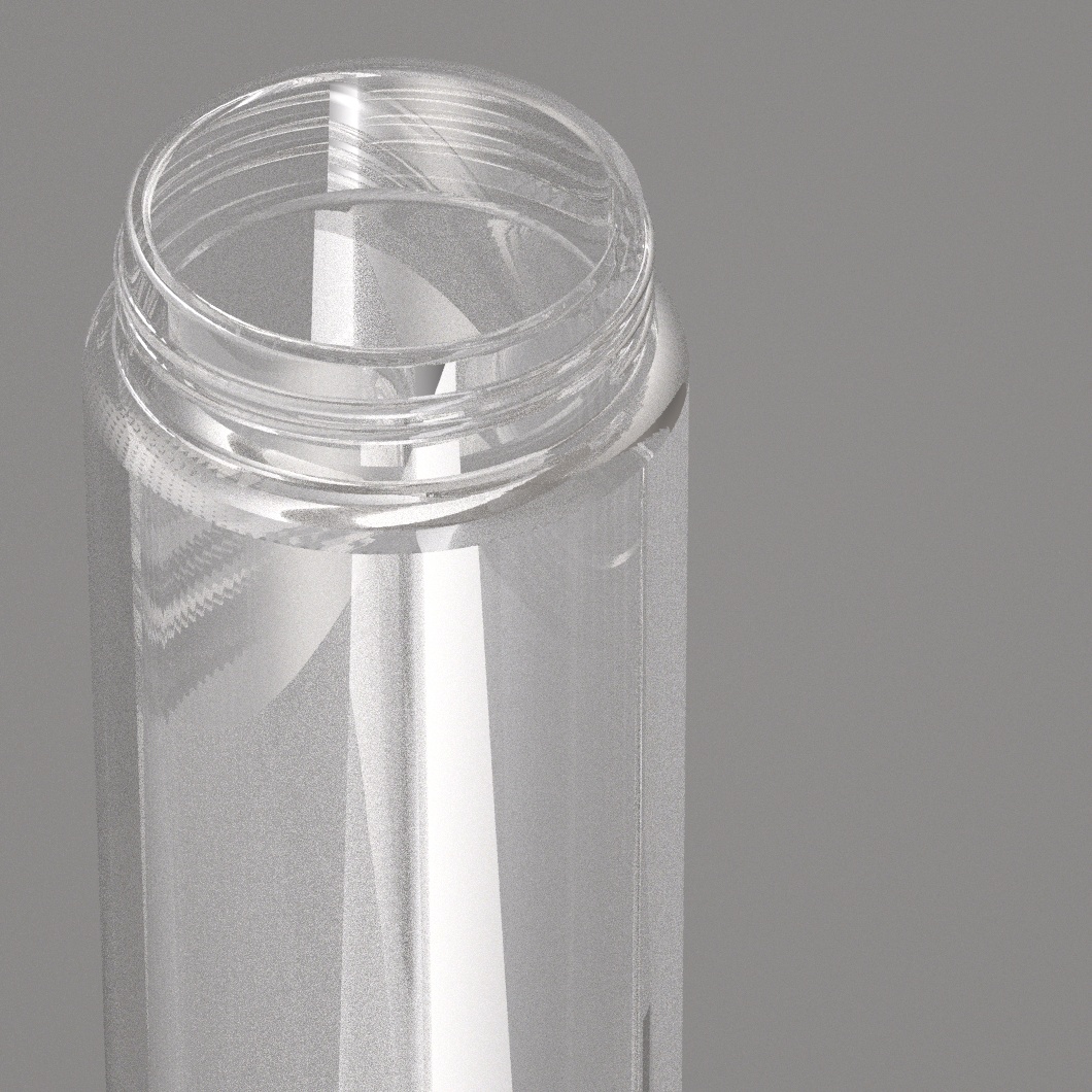

Hi Goldisart,Goldisart wrote:go to slate material whit render PMC
in my opinion there is need to modify the test ... there's a critical error
Yes, sorry about that, I forgot to mention that PMC has a known bug in 3.06 Test 3; that's fixed in Test 4, and it will be in next plugin release..
So for this test release, avoid to use PMC ..
Cheers
