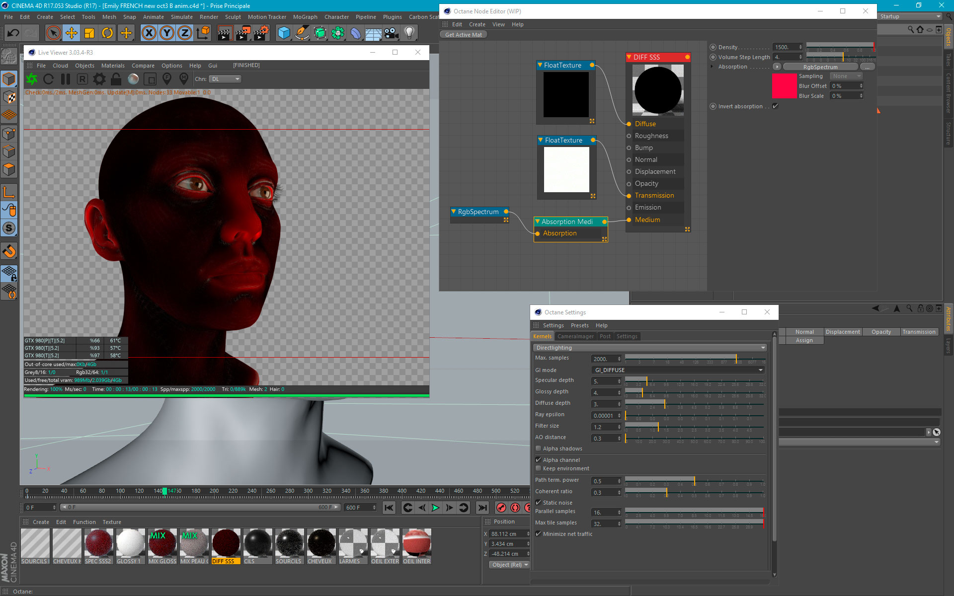

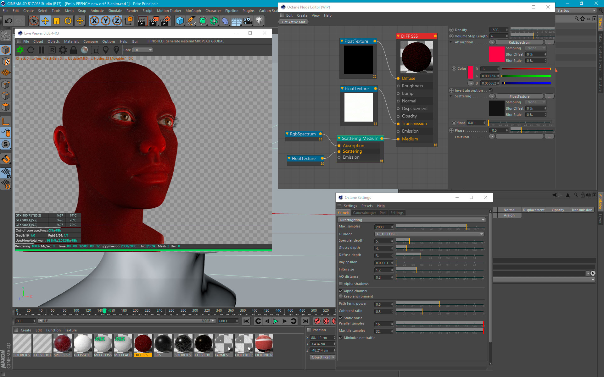

Here three samples of Scattering and Absorption mediums
Scattering medium
Scattering medium
Absorption medium
Absorption medium
Absorption medium with color in Diffuse port
