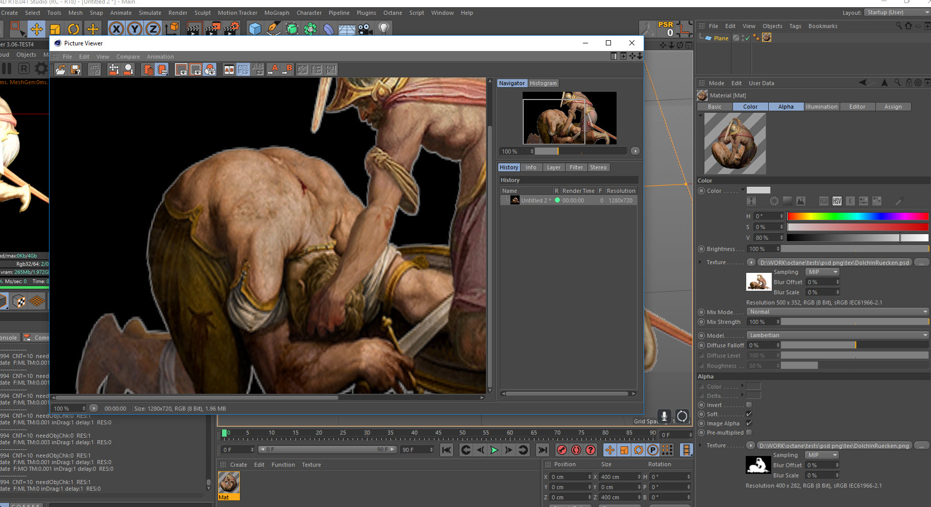

Sorry for my question, I was searching quite a bit in the forum and didnt find anything. I think this occured in the latest versions.
If I import a png24 with alpha and put on a plane via image texture: all good.
But if I import the same file as a .psd, I have to crank up the gamma for the image texture in the opacity channel to 8 to get rid of a nasty edge - disable partial alpha and pre-multiply don't do anything. I tried with photoshop cc 2014 and the latest.
What could be my mistake? Or what did change and how can I adapt?

mrom wrote:Sorry for my question, I was searching quite a bit in the forum and didnt find anything. I think this occured in the latest versions.
Thank you!
Have you checked on standard renderer? I did that seems like a problem with outlines in psd.

aoktar wrote: Have you checked on standard renderer? I did that seems like a problem with outlines in psd.
Thanks for getting back to me on the weekend, aoktar. It seems to be the case, but take a look at the attached file please:
The texture is a png (just a filled layer, I cut out the middle in Photoshop and scaled it down) - I made an octane and a c4d texture.
The cut area renders perfect, around the outside is a white fringe.
If I render in standard renderer, the white fringe from the c4d shader disappears (as it should), in octane it stays.
What could be the problem?
Thank you so much, I am getting a bit confused here ;)
Shading of image_texture in standard render that's not interpolated by any filters. It's implemented just for preview purposes and that's not high quality. So that's not expected results from a renderer. Standard material with starndard renderer is expected result. Because pixels are interpenetrated on line at from white to black. So you have to see a outer color on edges as you see.
