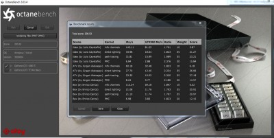

went over 200 in OctaneBench with Founders Edition 1080Ti a day ago & the other Guy pushed over 213 (with the same OC settings). Leaving the copy/pasted text from the post:
Since that will be an interesting topic for a lot of #OctaneRender users "how good #1080Ti actually is?", I will leave You with this print-screen:
200.53 in non official [3.03.4] #OctaneBench on air *
(out-of-the-box, without any tweaks it gives ~170)
EDIT: other are getting up to 213.5 with same settings
link: https://twitter.com/TeddyRockStea…/stat ... 2752417792
* with few tweaks:
Core Clock +210 (leading to 2063)
Memory Clock +555 (leading to 5562)
Fan Speed at 100% **
** the reason for later is to keep card as cool as possible (it would work on 75%, but fail on 50%), under full load it went up to 55C. If I slow the fan speed & temperature rise, somewhere between 70-80C card starts to throttle down (even if temperature limit is still set at 84C), lowering it's core clock & eventually fail (meaning that You need to reboot computer in order to run card at all).
Hope that is going to be useful for some of You.
