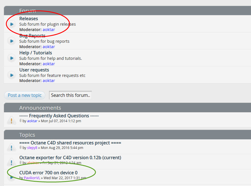

I can see the standalone version on this board, but where can I download Cinema4d version?
I can see only stable versions on downloads section. The last is 3.05.3. And no links on board.
Posts: 16068
Location: Türkiye
Here is

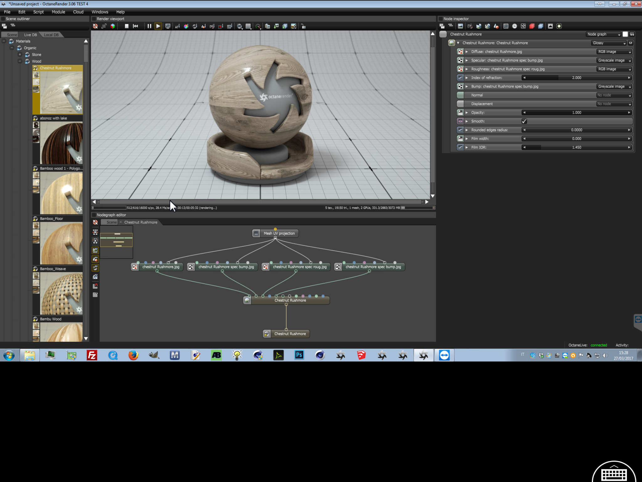

Hi Giz,
this is very weird, since Chestnut Rushmore is a simple Glossy materials with textures:
Probably there is something wrong in your hw and sw setup. My suggestion is to perform a clean installation of the nvidia drivers, maybe one version before of what you have installed.
What are the other specs of your machine?
ciao beppe
