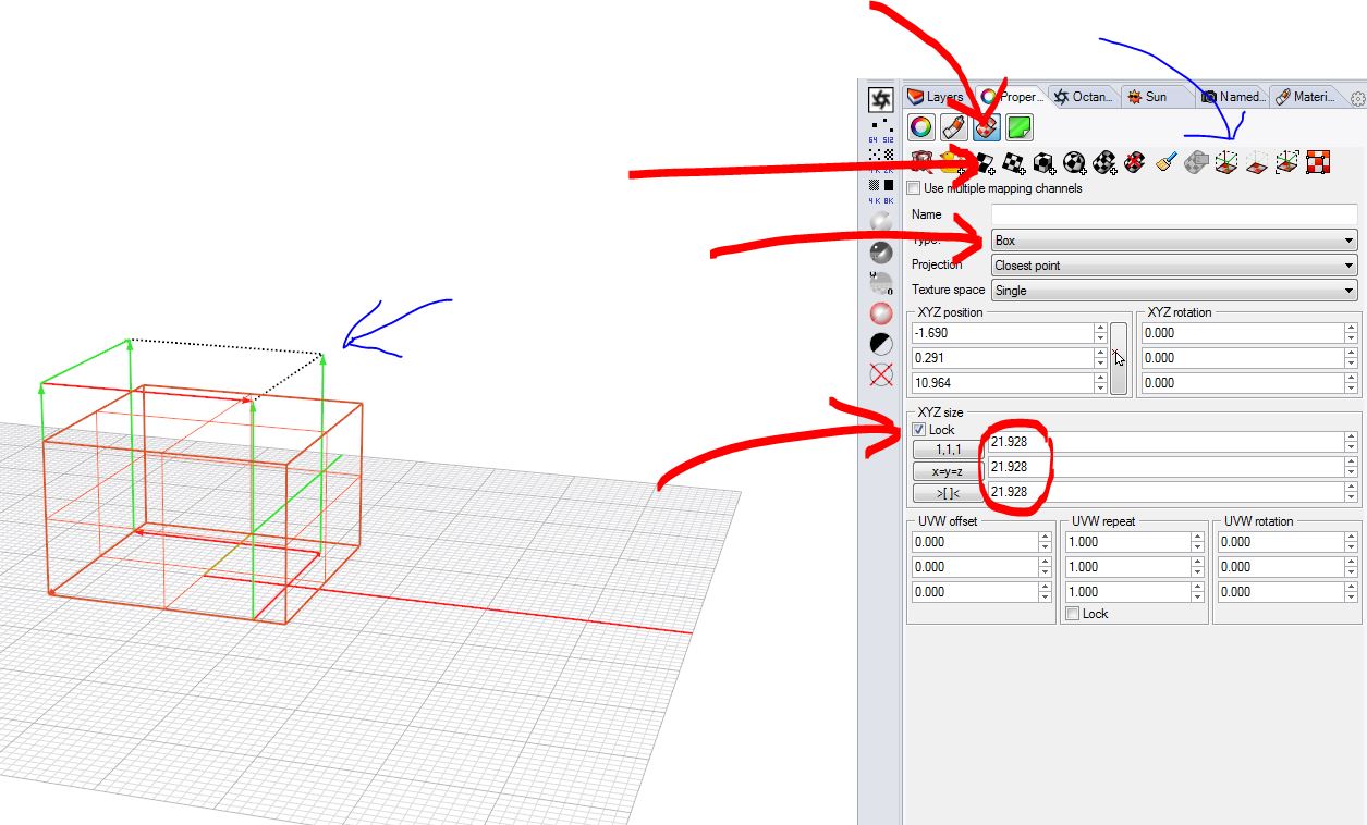

Hi Tim
Unless you are using some generated textures form octane (like turbulence) leave the mapping in octane material to "mesh UV" and do all the mapping in rhino properties - it will save you a lot of time and is much more convenient.
Secondly - in rhino object properties for texture I always use surface mapping, than choose box and then adjust the size - I usually lock the 3 axes so my mapping box is perfect cube.
Then you can us mapping widget to precisely position and scale your box mapping (and every other like cylinrical, plane etc).
Check this:
If you start messing with the scale in octane material mapping it self - you make your self lot of additional work since you will have to scale the mapping for every map, and render to see changes (with diffuse map you can see how the texture is mapped in rhino rendered viewport).
Regards,
Mac
