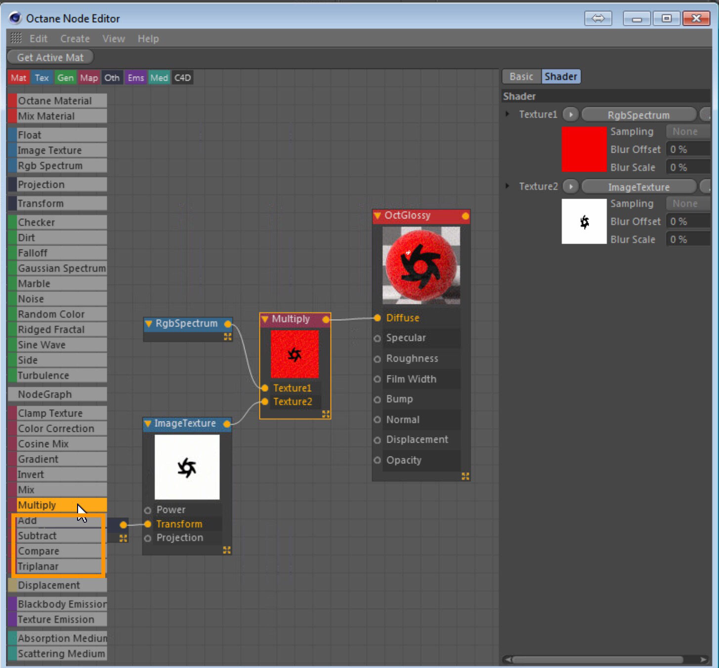

Simple question from a vrayforc4D user, what is the approach in octane to stack layers and use multiply?

Hi RizonParein,
I'm not a vrayforc4D user, do you mind to share some screenshots of what you need exactly?
In general, you have to use the dark red mapping nodes in the Node Editor:
The marked nodes like Add, Supstract ecc. are only available from v3.06 Test 2 version:
viewtopic.php?f=85&t=59657
ciao beppe

bepeg4d wrote:Hi RizonParein,
ciao beppe
Oh! Just see your reply, thanks man! that simple :)
