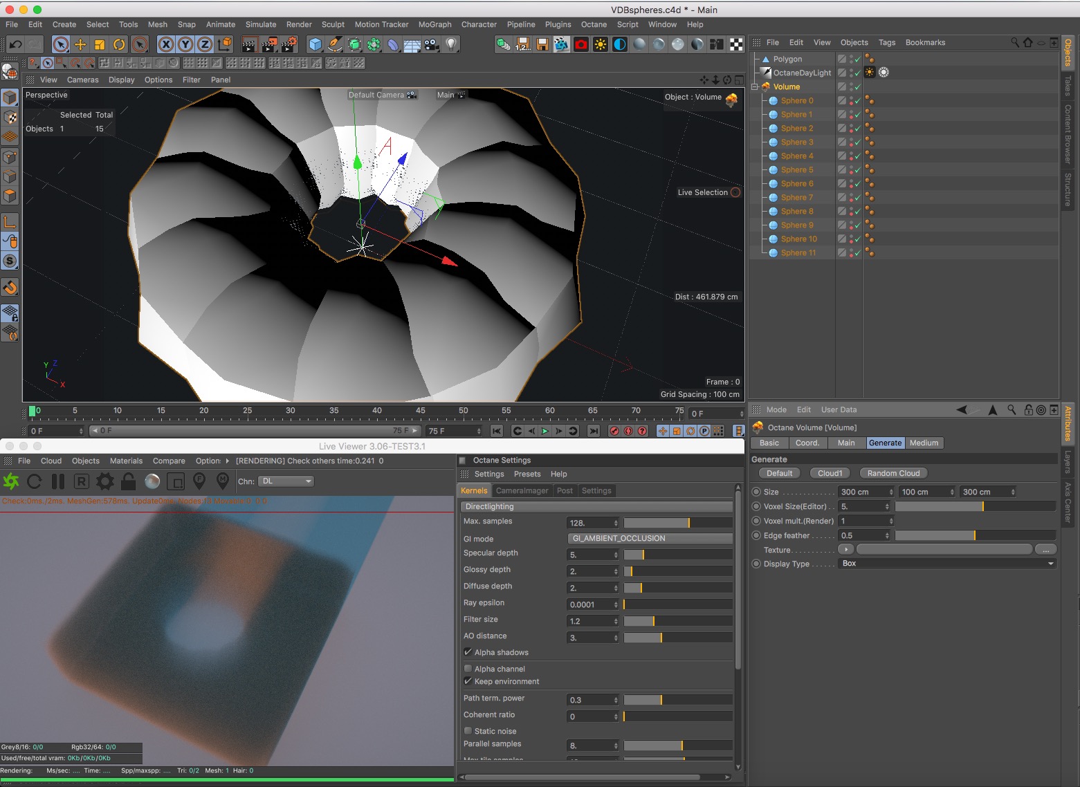

Hi jayroth,
look at this trick with twelve spheres:
VDBspheres.c4d.zip
(70.79 KiB) Downloaded 163 times
ciao beppe

That's very cool, beppe, I didn't know you could link up shapes that way!
Now, imagine a camera in the center of that, and the fog volumes getting more dense the further away from the camera. That is what I am really trying to achieve, and I have tried using volume gradients and other tricks to get that. I know it is not a "physically-based" condition, and I therefore doubt Octane will let me do it. But given that the noise functions effectively create clouds using the same methodology (volume where white, empty where black), then it seems to me that this would be allowed via the current implementation. Unfortunately, I see no way to control the way that textures are mapped into the volume. I was able to get some changes to the volume, but nothing that I could manage to control...
