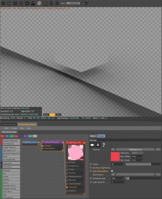

So I am trying to get out a shadow pass for compositing and it works except for these weird lines that show up across the entire plane. Any ideas what could be causing this?

I am having this issue and also tracked it down to 'Cast illumination' inside the Texture Emission node.
Disabling fixes the problem with the shadow pass.

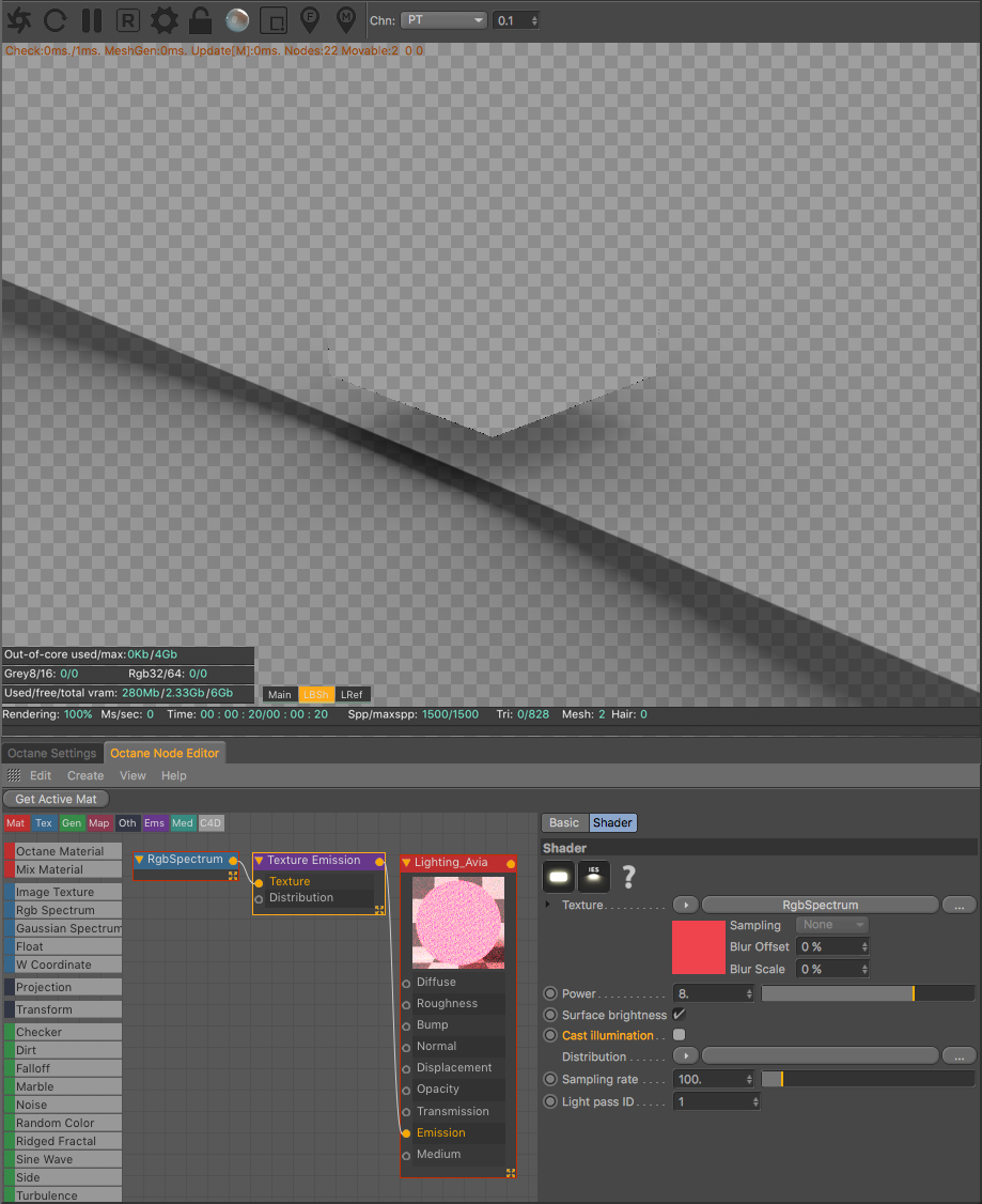

I can confirm the problem with and without an HDRI light source, or any other light source for that matter. The scene above does not have ANY other light source.
Project file attached.
