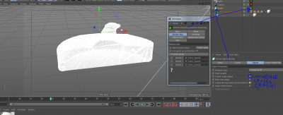

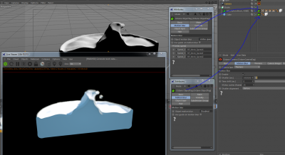

There is a problem with the vertex map based motion blur which causes crash in specific case (see attached screen).
If the object with vertex maps is passed through a generator (a boolean in this case) and the Octane Object tag is applied on top, it causes crash, because one of boolean results doesn't have the vertex maps (you can see when u do Current State To Object - one part will have the vertex maps carried over, while the other part not).
I think you can fix the crash by checking if the object actually has any vertex maps tags regardless of what is in the Octane Tag, just to circumvent the crash....
But if I put octane tags on the source objects, and put No Motionblur on the other part, there is no crash.

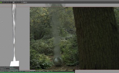

1: When trying to view Alpha channel in Live View it displays off to the left all squashed up:

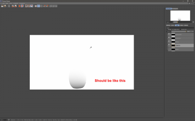

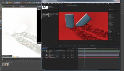

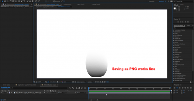

2: If I use Render Layer in settings to render shadows, I can only generate shadows for one object. For example, if I set 2 objects to ID number 1 and set the Render Layer to number 1, the shadow pass just ends up being white with no shadow. The same thing happens if I put my objects in a Null and add the Object tag to that. If I then go back and change the object ID's so that only one object has the number 1 the shadows for that object will render fine.

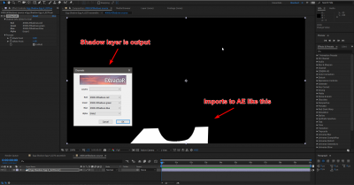

3: If I use Render Layer in settings to render shadows, even though the shadows are visible in the picture viewer, if I export as a multipass EXR and import into After Effects, there is no shadow information on the shadow channel. All other channels are working fine but the shadow channel is just a white alpha of the object I'm trying to render shadows for. I have tried saving out as PNG which works as it should.
Here are some images which I hope illustrate the issue:

You have to assign ID2 or bigger for seperated objects. All objects are on ID1 by defaults. Also there's not any problem for shadow layers as i can see.
Check this video if it helps: https://www.youtube.com/watch?v=Zh2p295 ... e=youtu.be

bartolos wrote:Ahmet,
Cheers,
B.
I'll check it if i can reproduce. thx

aoktar wrote:noisyboyuk,
Thanks dude!
I actually used ID #5 for both, I just used #1 as an example. Obviously that was a bad example to use as I didn't realise that. I will watch that video and check again to see if I can reproduce it in a new project file, hopefully it's just something I have missed.
How about viewing the alpha channel in Live Viewer? Is that something my end or a bug?
