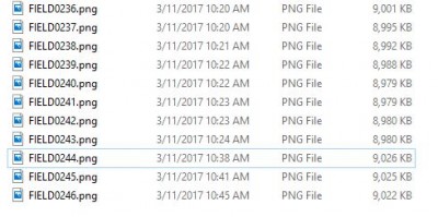

But let me show this. Frames 236-243 are rendered through the commandline.exe. Frames 244-246 is the same scene opened and rendered inside of C4D. That's the problem. Why the huge difference? It's the exact same scene.
The LV speed = commandline speed = standlone speed = fast!
C4D batch render or Picture Viewer = much slower. Same settings nothing else changed.
BTW, I'm not upset, just trying to understand why there's such a big difference.

Picture Viewer=slow is not making any sense on me. It should be at same speed of LV if resulted data diagram of objects are same. Just note that first frame takes more time because preparing all data for renderer. Next frames are generally much shorter on render times because just some data is refreshed. Of course this depends how is your scene and and how your set this.
Making a decision with one scene is common mistake in this forum. My advice that you check it on different scenes. If you still have same impression show me/us some scene and ask for assistancing. We may find better ways to optimise or some issues on your system.
