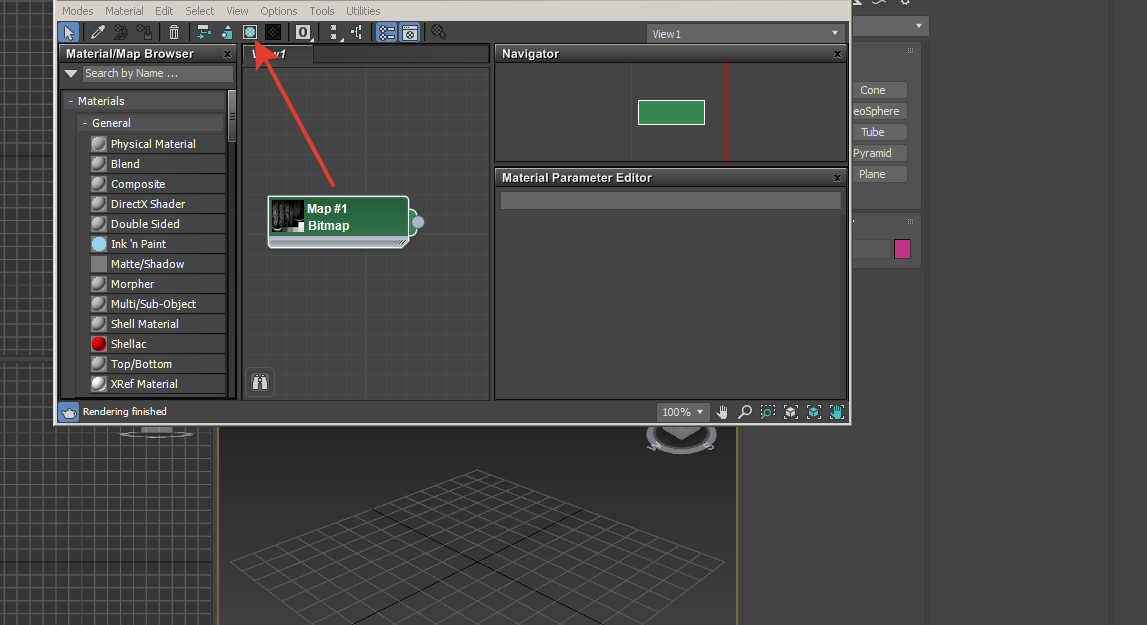

If you now open the material editor in slate instead of compact mode.
then use the "pick material from object " eye dropper and get the material in to the slate editor.
Find the bitmap node and then click "Show shaded material in viewport" on and of (the button Goldisar have pointedout in his image)
if you now scrub the timeline!!! IT UPDATES!!......

If you want to display animated texture in the viewport using octane shader you need to use the standard texture slot with a bitmap. and you need to use the slate editor display texture button instead of the compact one........

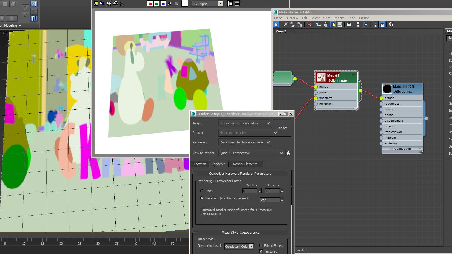

oooo I just remembered I did it via quicksilver render - visual style - COLOR
very very fast renders
