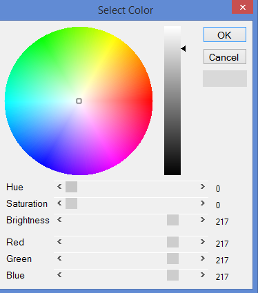

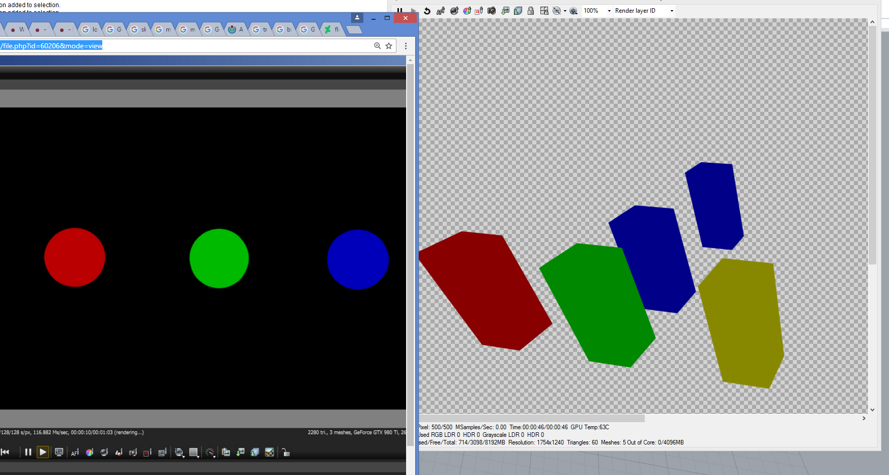

I have tried doing it for rhino and these were the colours I'm getting. It seems slightly darker, which may be a problem for after effects and possibly other programs.

franchais wrote: I have tried doing it for rhino and these were the colours I'm getting. It seems slightly darker, which may be a problem for after effects and possibly other programs.
If you are using Layer ID 1, 2, 4 as suggested by Jo, these are not pure Red Green and Blue.

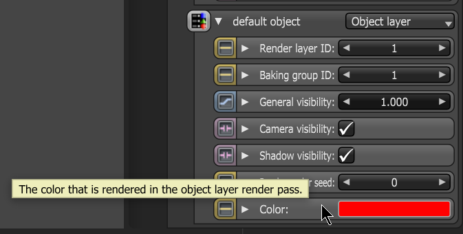

But there's a better/simpler workflow for that than using layerID,
you can set custom color by objects, this colors appear in the ObjectLayer pass.

Also the colors are slighly darker in rhino because the gama applied to tonemapped passes have been changed in 3.0.6
(now it's always 2.2 whatever is setup in the imager )
I just tried this with the 3.06 TEST 3 version of the plugin, and the color matched exactly. May I suggest trying with the next release (I will port a pre-release in a few minutes).
