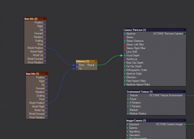

How can i target my camera DOF on one object and after another in animation ?
Or how can i animate focal depth ?
Acrom

You can animate camera focus with this simple setup.
you have to attach one item info node to a Null and the other item info node to a camera.

Thanks Ricardo ! So, when i move the null, the camera focus follow it ?

Yes, the distance between the null and the camera will always be put into the depth distance. it works fine.
