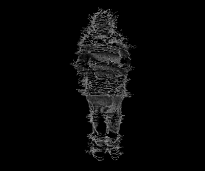

For reference, this is what the Mantra rendering of the scene looks like:
Example Mantra rendering of the scene

The plugin can render particle effects using the Octane native sphere primitive. You have more details about this workflow in the docs:
https://docs.otoy.com/manuals/products/ ... particles/
The plugin doesn't support the Houdini packed primitives yet (it is a planned feature for the near future), and the Copy SOP can't be used for instancing (internally the data is seen like real copies of the object, only Mantra understand it as an instancer) so I suppose that the particle rendering is the best workflow for this kind of effects.
